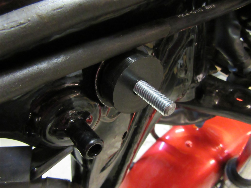

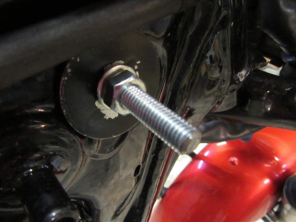

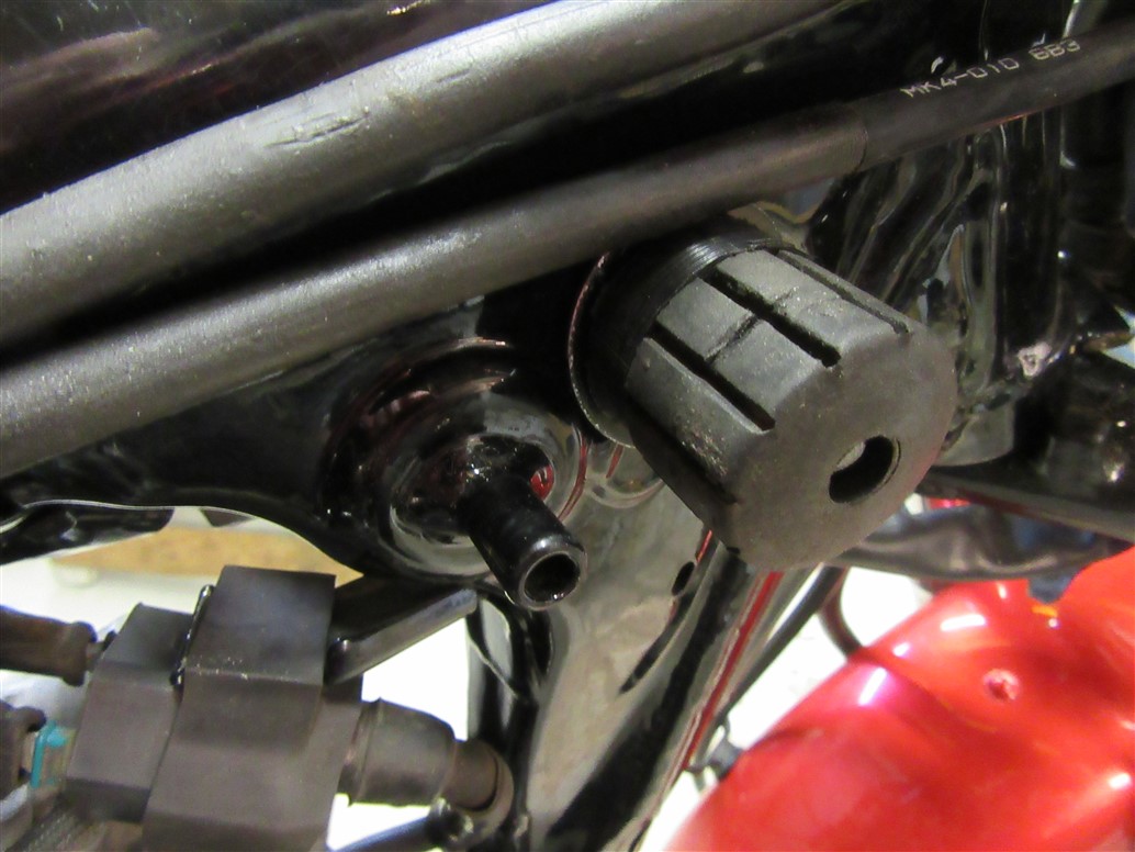

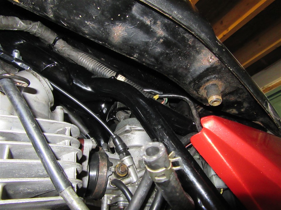

I've been working on the tank mounting. Following Matt's (IIRC) advice I've got a length of 8mm allthread that just fits behind the little tags in a hole in the frame above and forward of the standard mounting position. The CX500 tank is wider between the bobbins than the original, strangely enough, so I've made spacers from black nylon to sit on the studding and push the bobbins out. This is well nigh perfect at the front, giving about 10mm clearance from the forks on full lock.

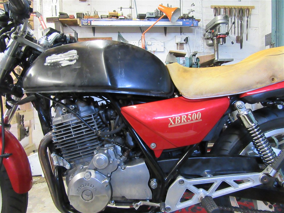

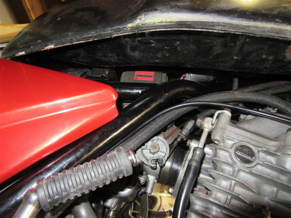

I've also been thinking about the side panels and discovered that if I lift the back of the tank about 10mm the panels will slip underneath and look almost as if they're meant to be there. I need to find some way of locating their front mountings however.
Also picked up a set of aerosols from Spraywell in Bromsgrove, matched to a side panel. I've never used 2 stage paint like this before. What can go wrong. The pack also includes an allegedly petrol and UV resistant lacquer. All for £60 - a lot but much cheaper than a professional job. Will it look as good? No......
Pics of the front tank mount: you can see the original bobbin mounts.

Top job Ian... looking forward to seeing the tank and side panels in place 👍

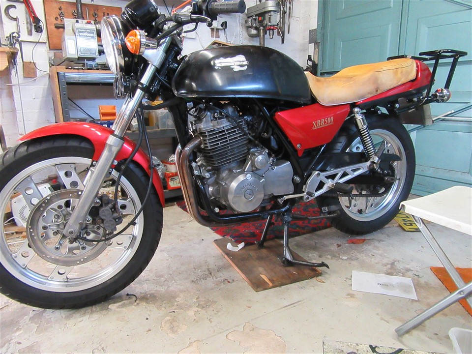

I've been playing with various bits and bobs to see what things look like. I've cut the peak off the seat base and cut the foam back a bit - leaving plenty for the upholsterer.

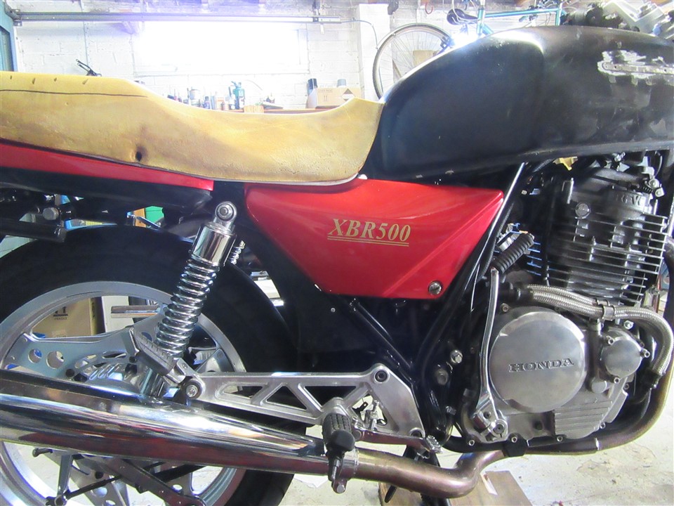

The main problem is the side panels. Problem 1: I've lost the front mounting (rubber grommet) but think I can fit a plate there using P clips on the frame tubes. No mods to roiginal remember.
Perhaps a worse issue is the way they line up - or don't - with the base of the tank. My current thought is an infill plate behind the panels painted red to match, but a better solution would be to locate another pair of side panels and extend them to line up with the tank base.
Here it is:

Hi Ian. Seat looks better already, I’m sure your upholstery will be able to work his magic to make it look like it was designed that way 🤞
Regarding the side panels. You could always use the ones you’ve got to make a plug from then slightly redesign the shape and make new ones out of fibreglass. A little time consuming but again once done they’d look like Mr Honda designed them that way
