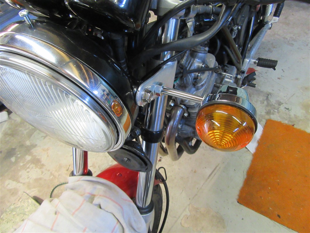

This is the pattern Goldie silencer. I started the bike up this morning and it's quite loud but nowhere near the one that came with the bike. Quite a nice deep sound. There are mutes available for the end if I decide I need to quiet it down a bit. If fitted onto the 45mm exhaust very nicely.
Pattern Lucas indicators - not original but I hated the tiny LED things the bike came with. Indicators and silencer came from the Classic Bike Shop a couple of miles away from me in Redditch https://www.classicbikeshop.co.uk/. They seem excellent quality and the indicators are better made than original Lucas ones. It's very much like I remember going to Vale Onslows in the 1970s but without the queues and surly counter staff.

That is coming along nicely by the look of things. Should be a nice mixture of old school and 80s chic.

Looking good Ian. The standard indicators are terrible so most people bin them. They are mounted on rubber / plastic stems and after this many years they go floppy!
The ones you have fitted suit the bike very well.
Ah that takes me back -Vale Onslows. Spot on about the queues and surly counter staff. My 1974 Suzuki GT185 was supplied by them from new. I swapped it for my RE Continental GT 535 with a friend in June.
