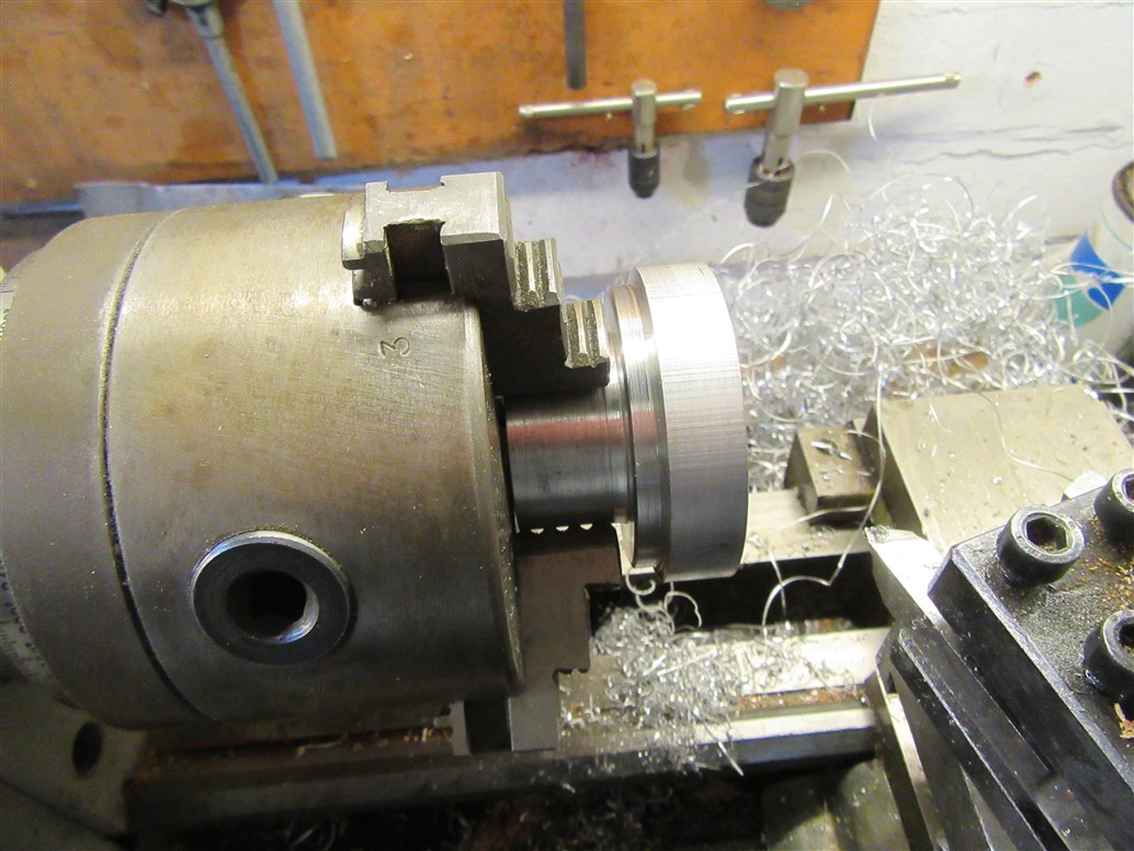

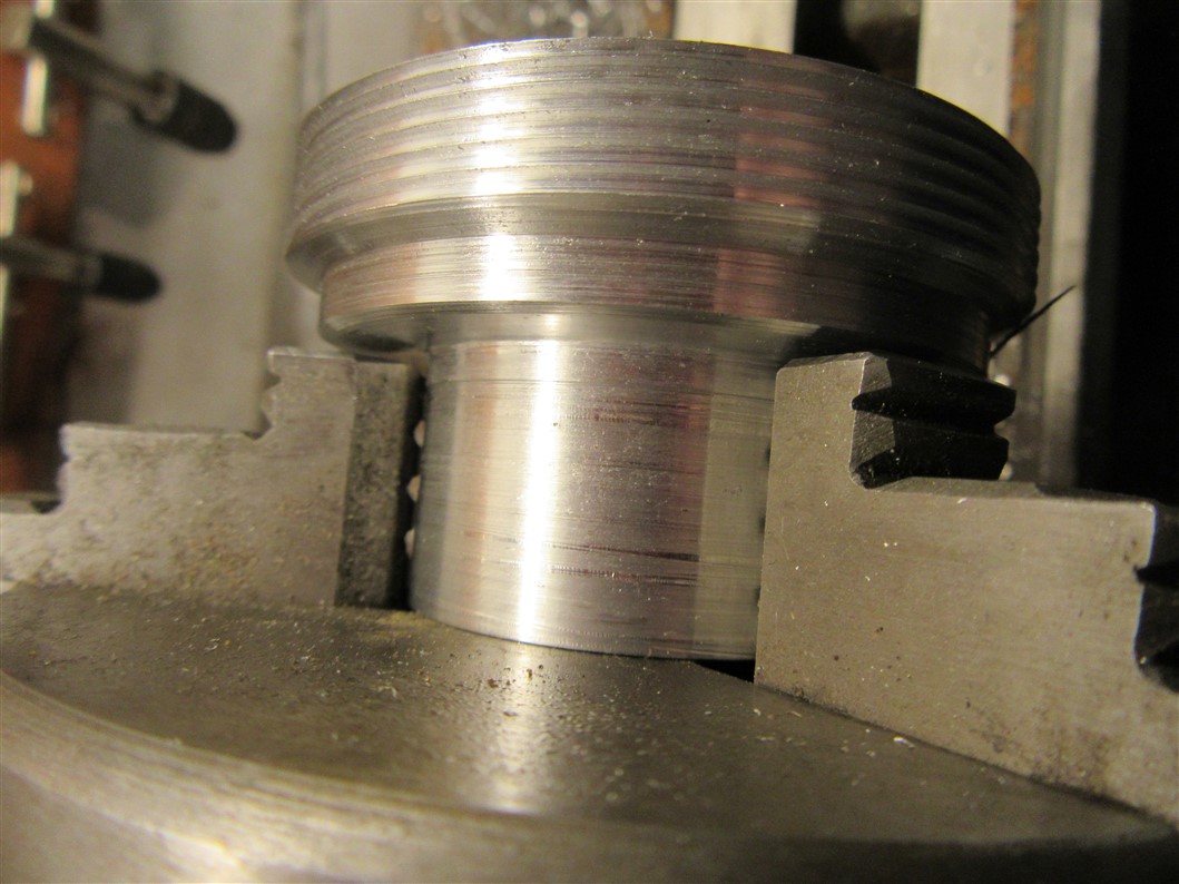

I've spent the morning producing piles of swarf and now have the main dimensions turned on my adaptor - cutting a 16 tpi thread and boring suitable holes through it remain to be done.

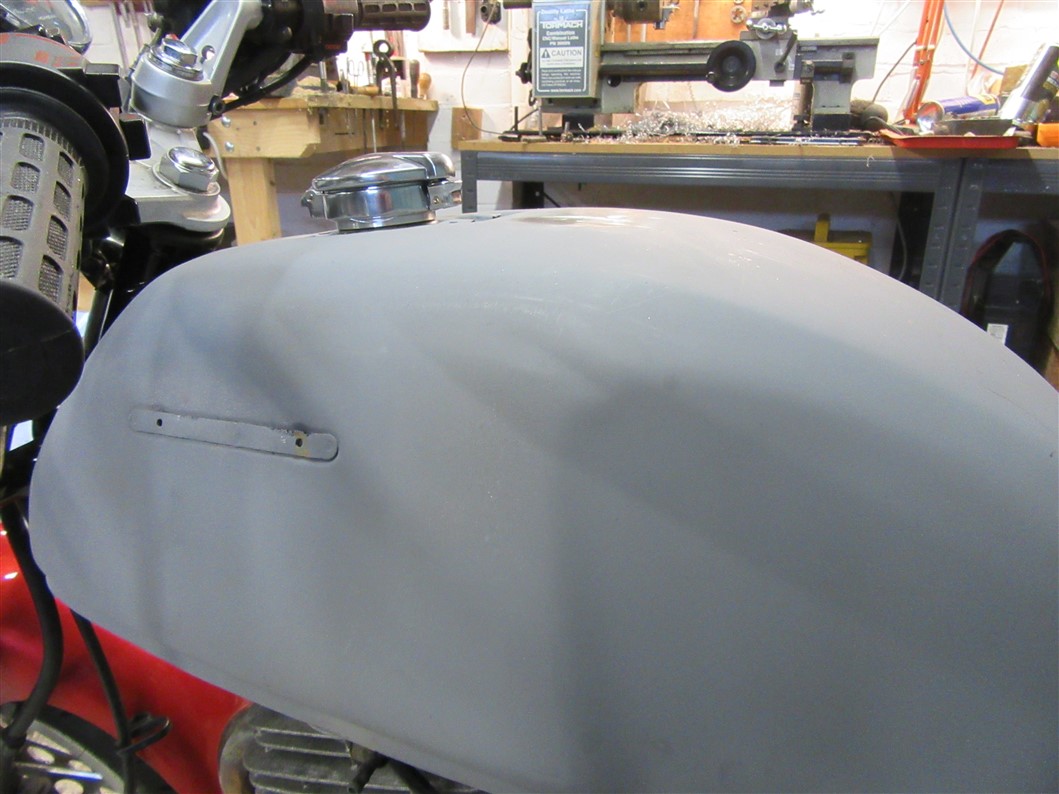

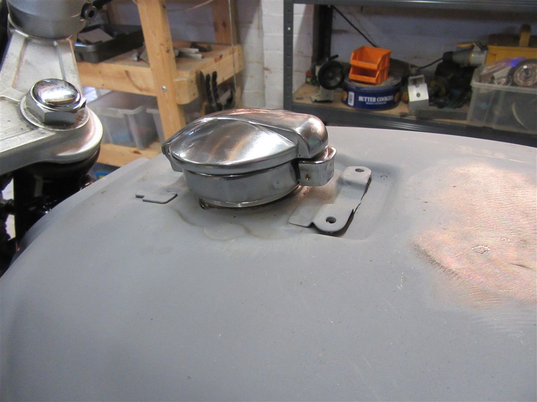

Thread cut:
The cap in place loosely. The depression where the original flap hinge etc will be filled up to the smaller diameter under the cap itself:
Have to stop now to prepare for a zoom this afternoon. But progress is being made. I'm expecting the new/old sidepanels in the next couple of days and have started away of attaching the front as they would normally mount to the sides of the XBR tank.

Starting to look the part now Ian. Just wait until you’re pouring the first gallon of moving juice through that monza filler and roarting off down the road 👍
