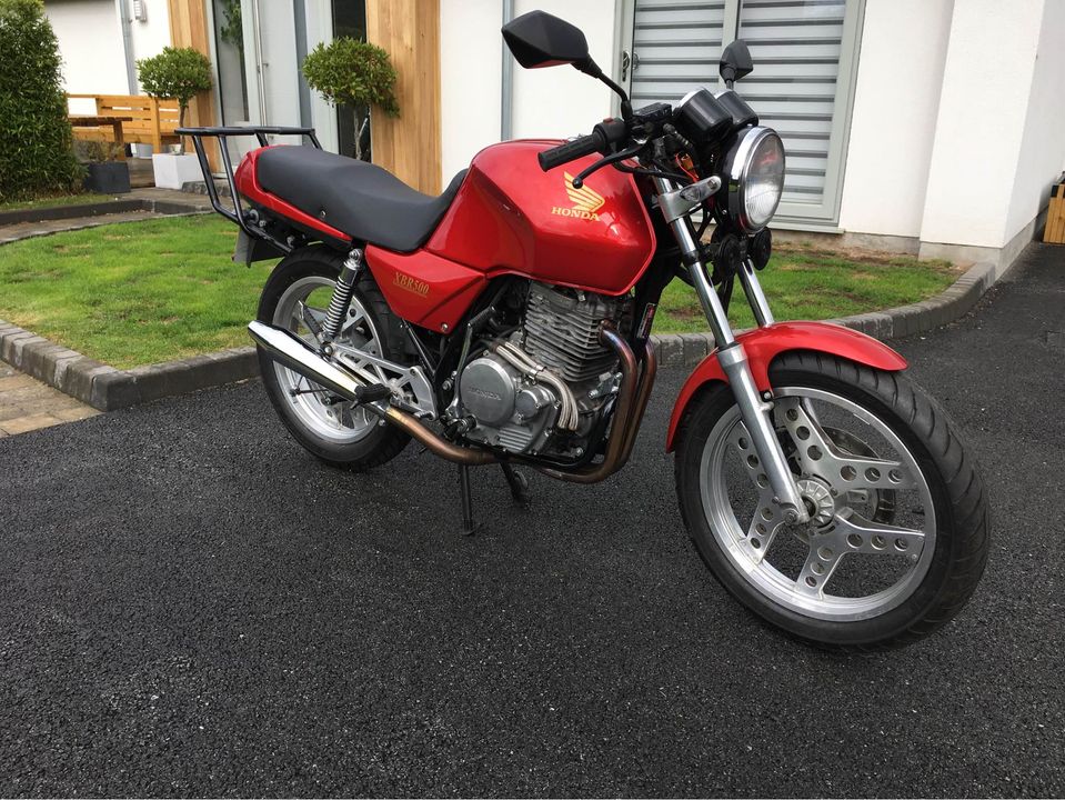

Just to recap - I initially wanted a CB400SS grey import. But wiser counsel, mostly from this forum prevailed and I am now in possession of a beautiful XBR500. I'm not going to go overboard with this but intend to fit a CX500 tank which seems to be the easiest fit / best looking, and mod a spare XBR seat by getting rid of the raised front end and possbly other things. I foresee side panels may prove interesting.
To remind my faithful public what it looks like:
Under the bonnet - all in excellent condition.

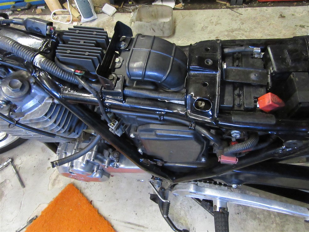

I've drained the oil and am awaiting filter etc from David Silver. Also checked the tappets which were fine. But I think I've found the source of the noise (apart from the silencer). The exhaust gaskets were squashed flat and the whole lot plastered with gun gum or similar. Bodge number 1 discovered...
The silencer as I expected is empty but this is in the exhaust going into it:
I don't know whether it's fixed as part of the exhaust or not.
