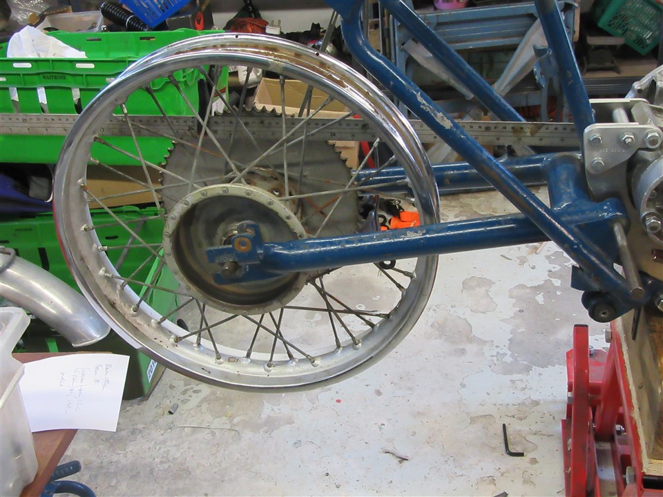

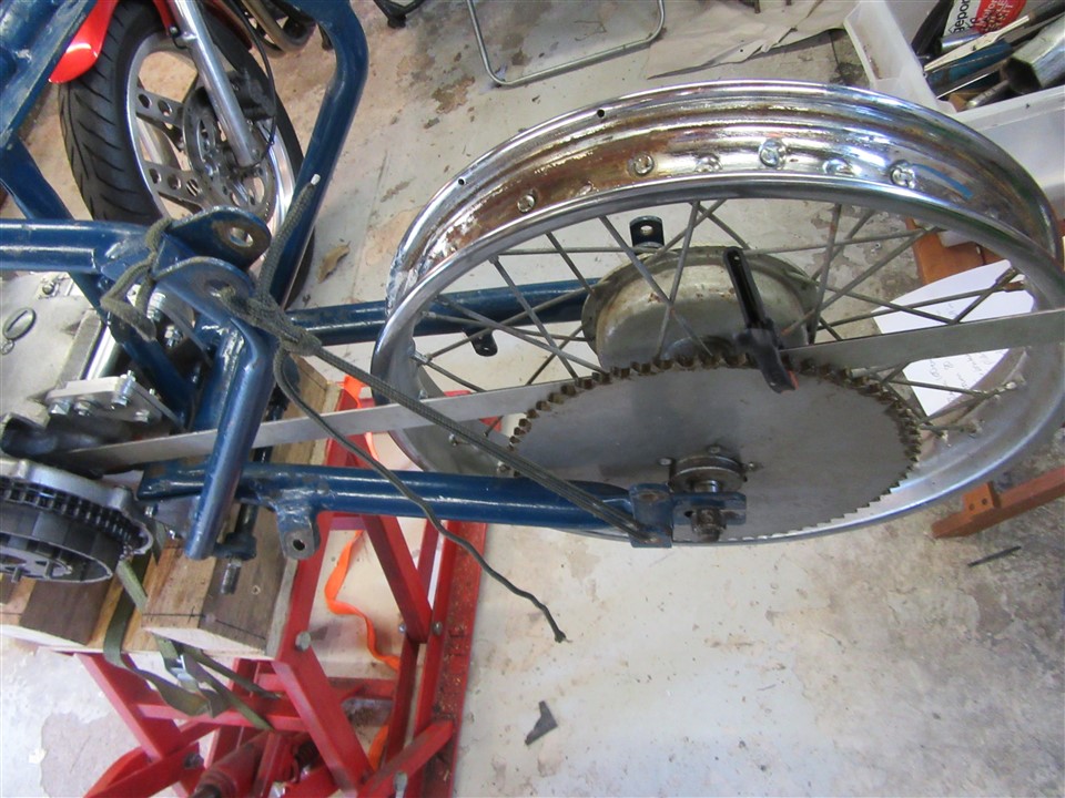

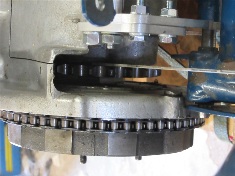

Time to check whether the gearbox sprocket lines up with the rear sprocket. This is with the 3/8 width gearbox and the 1/4 rear wheel so checking on the inside faces. It's looking pretty good - thanks to Phil Hyde who made the engine plates and spacers. I will be fitting a much smaller rear sprocket anyway as I'm not intending to compete at Red Marley.
I'll be buying one of these: https://simplybearings.co.uk/shop/p20229935/Branded-51-Tooth-10B-Simplex-Platewheel-for-5/8-inch-Pitch-Chain/product_info.html but am dithering between 51 and 53 teeth - I loike an odd number as it spreads the wear. 51 will give me 12.4 mph / 1,000 engine rpm; 53 will give 11.95 with the 19 tooth gearbox sprocket. Quite low geared but should give a top speed north of 50 which will be fine.
