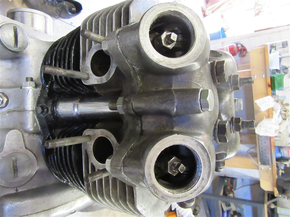

Cylinder head now on. I was a bit nervous about this as people have said it's hard to locate pushrods etc but it all went together very easily. No doubt I have something wrong. It was much easier to do the engine assembly without the frame getting in the way.
The pushrod tubes are notorious for leaking oil but hopefully the wellseal I've used everywhere will stop that. Who knows?
Next job is to insert the gearbox internals - I've done test assemblies of this so don't anticipate too may issues.

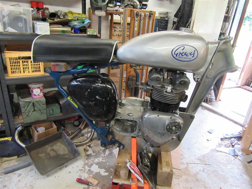

I thought I'd do a trial assembly of the frame loops and tanks etc - looking quite good although the tank is very close to the rocker boxes. I've used 2 of the head bolts that have a threaded extension for a head steady but since the photo have replaced these with ordinary ones as I'm not fitting a head steady - I may regret this later. That gives me an extra inch or so even with the rocker feed installed. I have the gearbox internals ready to fit - just waiting for some Allen screws from Nooky's nuts. I'd already bought a set but they seem to have made a bid for freedom.....
Looking good I think although the hard stuff is yet to do.
Ian.
