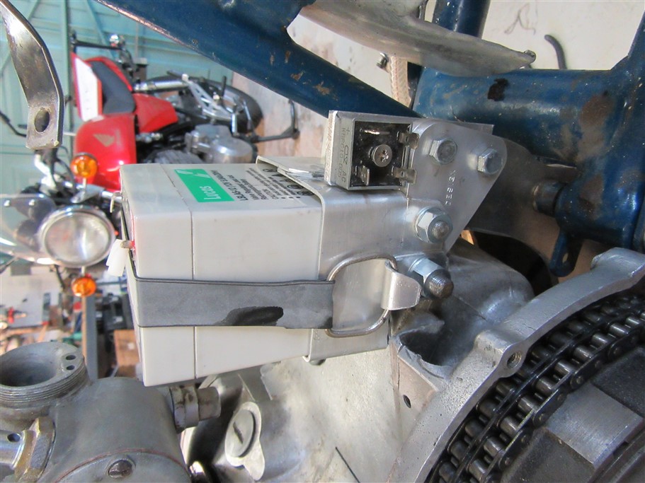

« Reply #66 on: August 08, 2023, 11:38:17 AM »
Battery box showing Zener diode and rectifier. The clips on the securing strap (made from an old inner tube) look a bit crude so will remake them.

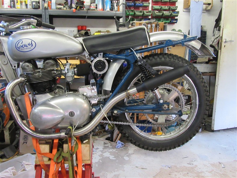

« Reply #72 on: September 25, 2023, 03:00:56 PM »
A bit more progress. Oil tank all sorted out and plumbed in (pics to follow as it's on the other side). Chain fitted - it needed a cranked (half) link which was difficult to find. Chinese Mikuni copy carb fitted - no idea whether it will work but the correct monobloc is in a right state and this was only £16 delivered from China. But the major step forward is starting work on the exhaust - this is the left (drive) side one with the polylock flexible section inserted and a "chopper pot" silencer. I did try a chrome one but it made everything else look too scruffy.
The exhaust is in place but not finally snugged down but I'm pleased with the look and I think I can see how to sort the rear brake pedal out.
