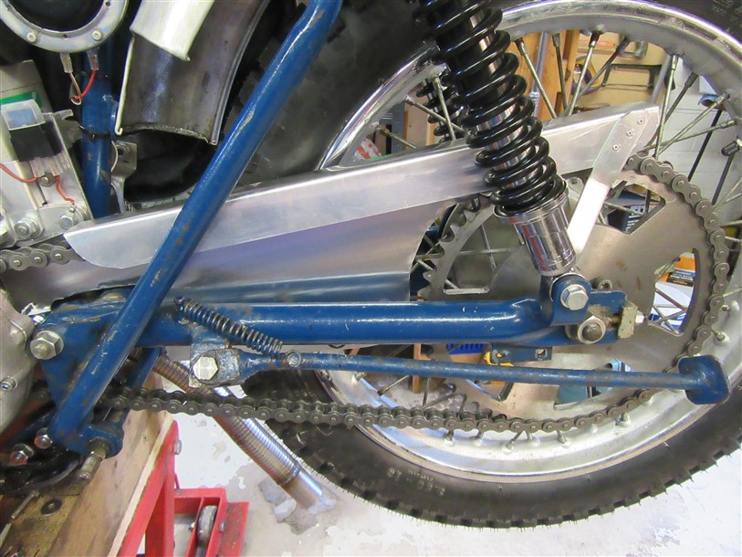

« Reply #80 on: September 29, 2023, 02:58:01 PM »
Made the chainguard - total cost about £4......

Re: Grumph / Tri-Greeves
« Reply #81 on: September 30, 2023, 07:49:12 PM »
Not at all bad Ian. However if I'd made it I would have made sure it was too short, uneven along it's length and would have had 5 holes for the bracket as 2 of them would have been drilled in the wrong place!
Seriously that is looking really nice, lovely job.
