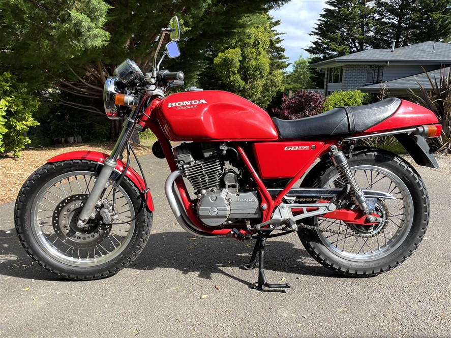

Just came across this pic of a 1992 GB250 (Japanese only I think) which is very much the look I'm after (apart from the red frame!). That tank is very similar in profile to the CX500 one. I think my side panels will look better however.
Ian.

« Reply #138 on: December 15, 2022, 07:49:31 AM »
Oooo that is flippin' lovely. I love the red frame, I used to paint the frames of my trail CZs red as I'm sure it made them lighter and better handling. I think the GB250 looks so useable and simple, if your XBR turns out anything like that I might have to be guilty of a little envy.
