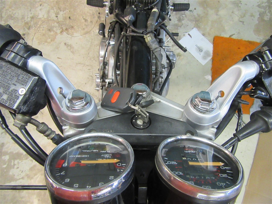

Checked the VF400 bars to be sure they'll fit - they'll be about 45mm higher and 40mm further back. I think the cables will reach except maybe the choke so I may have to make a new one. Gave the bars a couple of coats of wheel paint which gives a nice silver colour.

And here are the repainted VX400 bars installed. Everything fitted very nicely except the choke cable which I will have to remake 3 or 4 inches longer. It's an awkward thing though. The bars look as though they were made for the job.

those bars look great ian nice work your doing on this xbr ..tommy
