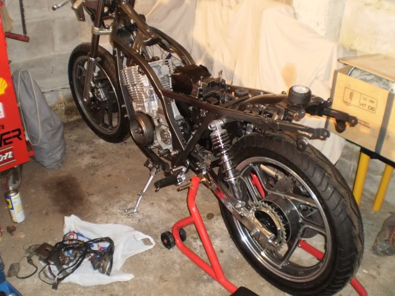

« on: April 16, 2010, 06:36:44 PM »
Hi there. Thought I'd share some pics of my SRX project. Shouldn't be too long before I try to start it up...how do I get pics on to here?

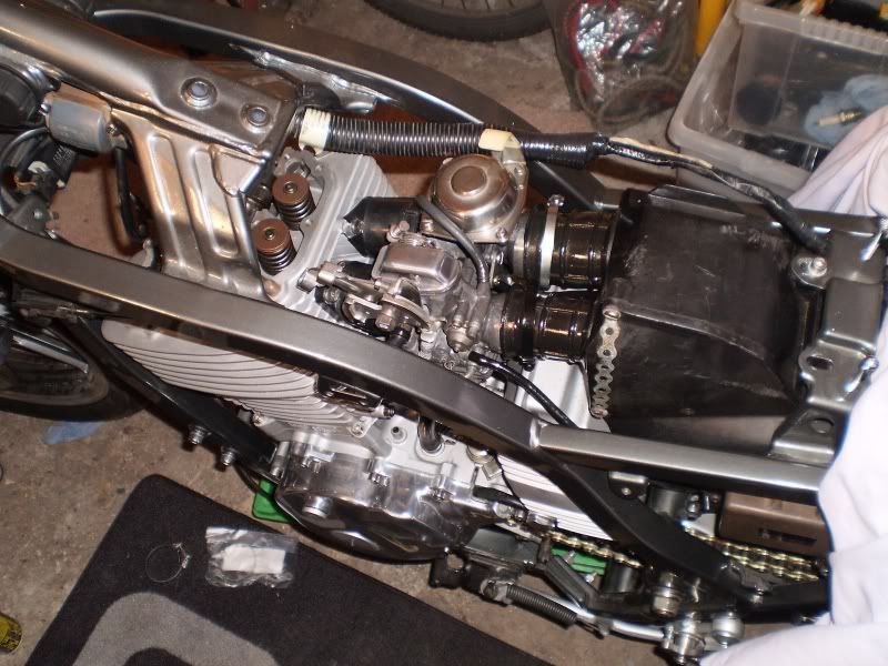

« Reply #4 on: May 26, 2010, 10:01:57 AM »
Hi. Here are afew random pics of the SRX. It now has an exhaust on it but the carbs are off having a bath in cola. I had a spark but no fuel getting through so carbs must be bunged up. Once I can get him running it'll just be a question of doing the paintjob & some serious polishing! May even be on the road this summer!

« Reply #7 on: May 29, 2010, 09:56:26 AM »
nice and shiney, is that a 4/600?
and whays the idea behind the twin carb setup, is one for low speed and the other high so to speak?

« Reply #8 on: May 29, 2010, 11:53:30 PM »
They all had the twin carb set up...Yamaha reckon its to help with economy but Im sure someone else will come along and give you the technical heave ho on them

« Reply #9 on: June 07, 2010, 03:37:02 PM »
Yes, apparently the smaller one does lower speed running then the big one takes over at higher revs. This gives great fuel economy for the performance so they say...
I'll just be happy if mine starts & runs OK! I'm almost at the stage of trying to start it having stripped the carbs apart and soaked them in coke for a good week. I had them in an ultrasonic bath (tip- NEVER start an ultrasonic bath with fresh, fizzy coke in it unless you want to be cleaning it up for ever after  :-[)
So, having soaked and buzzed them in a coke bath I cleaned them with water in said ultrasonic bath. There was a lot of gunk in the bottom of it afterwards so fingers crossed they cleaned up OK. :-\
