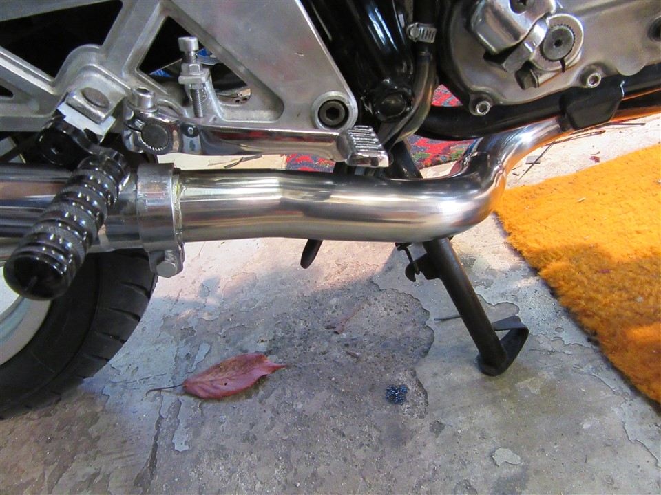

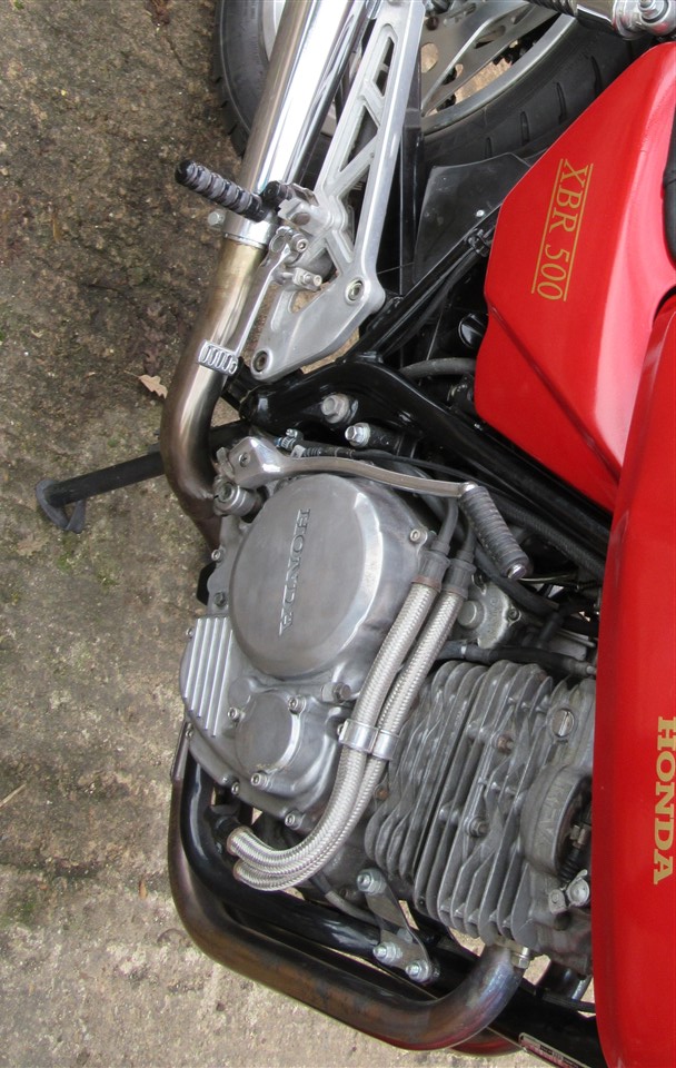

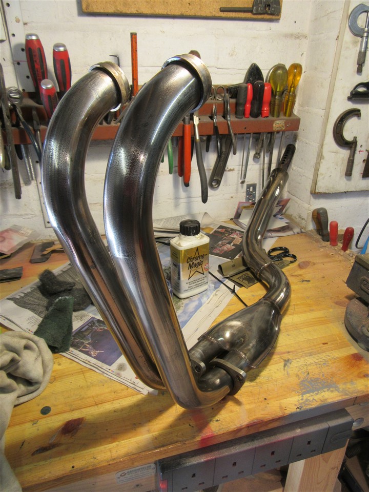

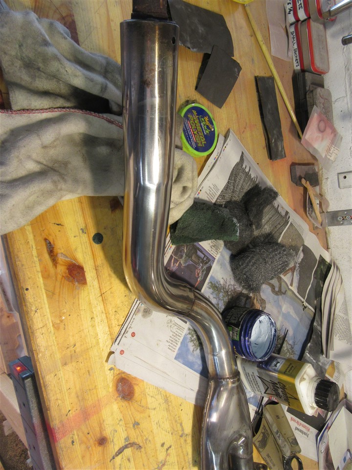

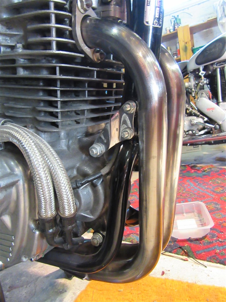

I was sitting in the garage admiring my handiwork when I noticed the state of the exhaust front pipes. They're stainless and quite badly disoloured (see pic 1). Some years ago I had the stainless pipes on my Guzzi V50 professionally polished and it cost nearly as much as chroming!
So I decided to see what could be done with elbow grease and carefully selected materials. I started with 1200 grit wet & dry lubricated with T-cut then moved on to wire wool then sctotchbrite. I finally finished off with chrome polish applied and buffed up with a soft cotton cloth.
Now while not up to professional standards it was well worth a couple of hours work.
Original:
After polishing:

A great result Ian and money saved-well done.
kevberlin
  • Posts: 157
Re: My XBR project
« Reply #197 on: February 05, 2023, 04:43:11 PM »
Nothing more satisfying than a good result after a bit of elbow grease. Look great.
 I’ve found crunched up silver foil to be a good addition to the polishing armoury.

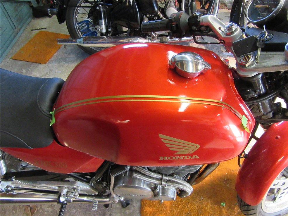

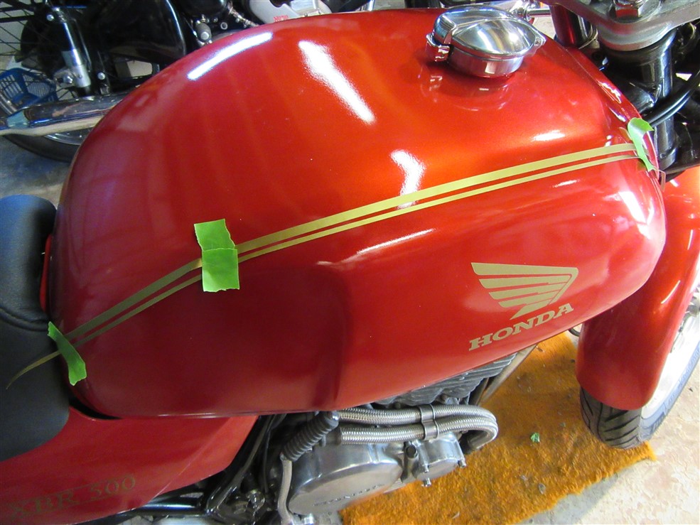

... that adding pinstripes to the tank would be a good idea? It looks a bit blank without. Ideally I'd like something like a Manx Norton pattern but getting curvature on wider tape is tricky. A couple of mock-ups:
I think further down the shoulder looks better.
This would be my ideal (in gold) but too hard:

I'd think the Norton stripes would be paint?
Pin striping... try keep it warm so it's pliable
Re: My XBR project
« Reply #202 on: February 06, 2023, 01:31:15 PM »
Yes indeed they would have been, and hand applied to boot. My attempts on my ES2:
Done with One-Shot signwiriter's enamel brush applied between 3mm 3M tape. It works well but gold paint is a different matter. Here is the same technique I used on a Sunbeam I restored some years ago:
Unfortunately the gold lacquer I used was far from petrol resistant even with halford's allegedly petrol proof lacquer.
With the XBR I have spent much time and effort on the red finish so want to use a simpler method hence using pinstripe tape. I did use the tape for a restoration of a Francis Barnett a couple of years ago but only 3mm narrow stuff so the bends worked fairly well. However you can see an imperfection in the tight curve behind and below the knee pad. I wouldn't get away with that using the 6mm wider tape hence my thoughts of keeping it simple.
Re: My XBR project
« Reply #203 on: February 06, 2023, 01:33:41 PM »
Pinstriping mockup looks really good! With your previous  results painting the Norton,  everyone will be expecting another first class job. No pressure.  8)

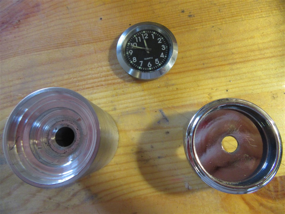

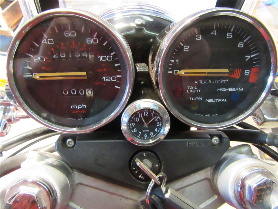

I always like to have a clock on my bikes so I don't miss closing time! I'd forgotten that I'd ordered this one from ebay. It comes with a handlebar attachment which is obviously no use for the XBR so 40mm of aluminium alloy from Rapid Metals and an hour or so on the lathe produced a nice little mounting to fit between the speedo and rev counter. Looks quite good I think. About £6.50 for the clock (it comes from China so takes a long time t arrive hence my forgetting it) and a couple of quid for the alloy.
Components - the supplied clip is to the right, my manufactured mount to the left:
In place matching up quite nicely:
I can fit the original mount to the Norton and swap the clock back & forth.

Yet another good result Ian.... but don’t look now but I think you’ve missed closing time ?😉
  • Posts: 1131
Re: My XBR project
« Reply #206 on: February 11, 2023, 03:11:19 PM »
Neat job as always Ian.
I could do with a clock like this for some of my bikes. Could you provide a link please?
Re: My XBR project
« Reply #207 on: February 11, 2023, 03:18:32 PM »
This is it Martin: https://www.ebay.co.uk/itm/195144145547
Can't guarantee how long it will last. It looks exactly the same as ones sold for £30+ by various dealers.
  • Posts: 1131
Re: My XBR project
« Reply #208 on: February 11, 2023, 07:53:07 PM »
Thanks Ian.
I bought one of the £30 ish ones for my RE Interceptor 650 , it lasted around 12 moths and cost a small fortune for a new battery so I agree it's worth a risk at that price.
