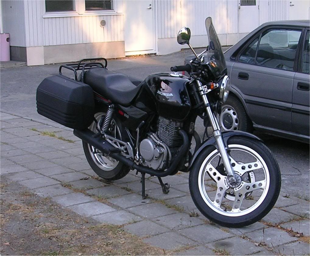

So maybe it`s better to stick with standart sizes. I`m not going to do any big mods to get wider tires. Bike looks just fine enough way it is. Btw here is my bike
My XBR -88

  • Posts: 4852
Re: XBR 500 tires
« Reply #11 on: January 31, 2007, 05:30:38 PM »
Aye Tuoppo,
Looks a nice motorcycle.
I see from the photo your daylight hasn't come back yet. Our's is improving in Scotland at the moment.
Have you had our snow, because we haven't had any so far this winter?
Enjoy the XBR.
Regards, Bill

« Reply #13 on: January 31, 2007, 07:18:14 PM »
Btw here is my bike
Looks grand. What boxes are those?
Tuoppo
Re: XBR 500 tires
« Reply #14 on: January 31, 2007, 07:39:10 PM »
I`m not sure because there is no label and boxes came with the bike. I have seen a couple pictures on the web where XBR`s have same kind of boxes and boxholders. Boxholders also fit very nice so maybe these are original?
