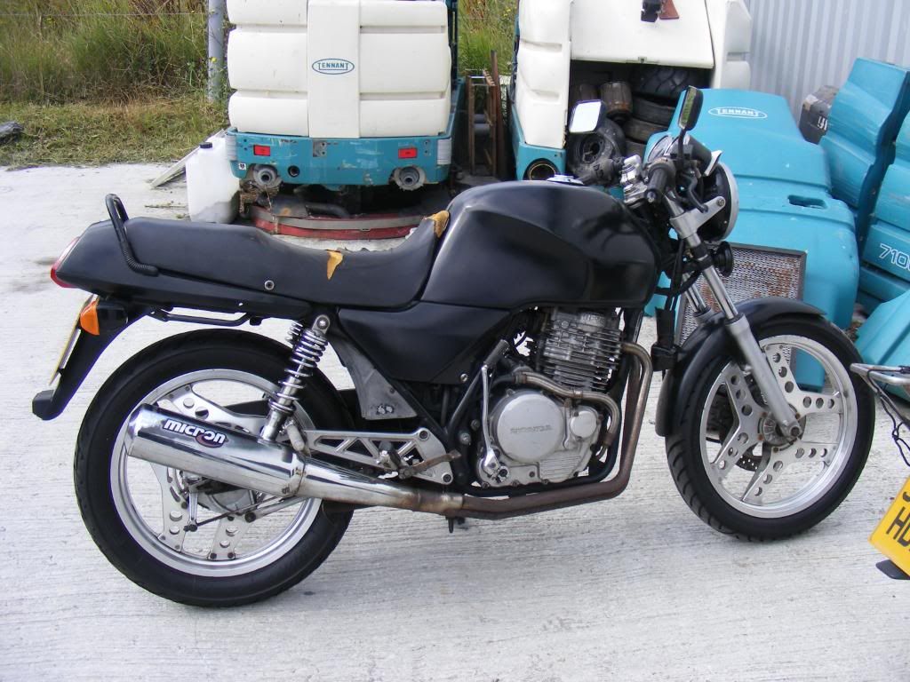

Got it last week.
Its a runner with 60,500 miles
Engine sounds OK
Micron 2-1
Recent rear shocks
VERY good AVON tyres

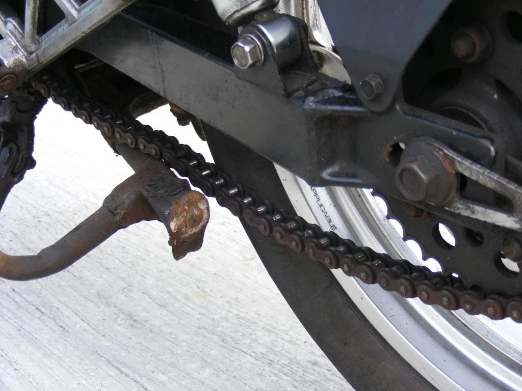

Chain & Sprocket JUST ordered....
As the centre stand was used as a chain tensioner.....

Fitted
new chain & sprockets

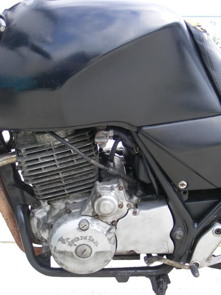

Anyone here fitted a new camchain ?
I AM capable of doing it ..
Have fitted camchains to Triumph Hinckley triples, XT500, CB250RS.
Need to know if its just the usual cam box / clutch cover off job ?
Anyone got a FREE link to a workshop manual or a CD one PLEASE ???
Mine is clacking now & again & gets quieter if you move the chrome tensioner plate
at the top of the cylinder head..
Also ive noticed that my tensioner is horizontzal...
Does this show that the camchain is worn out as im sure ive seen some vertical ???
What would you recommend I change , its covered 60 thousand miles & otherwise sounds fine after I adjusted the tappets.

Brand new DID camchain fitted.
Rocker box off, clutch cover off, Clutch off, oil pump drive & crank r/h gear side off.
Replace 1 x cam follower...
& rebuild.
Sounds really sweet now.
