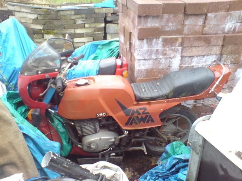

Oh and a Jawa/MZ beast.
GPz500, no ta, (but no offence), whats the Jawa/MZ???  Thats got me interested (maybe!)
1974 Jawa frame, MZ250 engine, YPVS pipe, Dunstall bodykit, Suzuki GSX250 forks and wheels, BMW R90 bikini fairing. It's, erm, interesting. I have plans to strip it back and do something a little fresh with it. We shall see.
Hmmmm!!  Maybe I like (even if it is a stroker....)
Any pics?
Is the frame definately built in 74??  ie. not, maybe, 1973, if you see where I'm going with this no-tax-to-the-tories type idea??    ;D

This is the only picture I have of it, and I'm afraid it is very much a 1974 bike.
Re: DR650 - rear shock or say goodbye ??
« Reply #13 on: May 13, 2010, 09:39:27 AM »
Thanks for the piccy!  Looks interesting!
