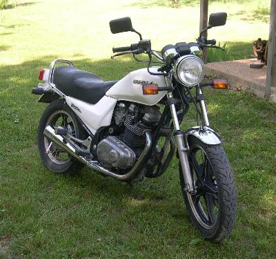

GR650? I've not heard of that. Is this the bike?

As I said in bits...
Currently has an Astralite wheel poked in the back to see if it looks better, and the tank and seat are away at this guy (Here) who is making molds from the seat and fairing - not in the pic, but apparently comes off a 1970's Kwak 3 - he was going to copy the tank too but it is just too rough.
Front end is Guzzi V50, was looking for a spoked wheel but if I either modify the swinging arm to make space for the Astralite, or get a different swinging arm then the cast front will look OK - mind a nice gold 18" Astralite front would look good too.
The engine in there is empty cases, I have a complete engine in a box waiting to go in as and when I get the rolling chassis sorted.
Frame is a GT250, with some bracing added - not quite right the bracing but it will do.  We had to cut the frame rails at the front and weld in a section of the T500 frame as the exhausts and frame were in the same place.
Has only been an on going project for about 25 years, so I guess another 25 will see it finished  ;D
