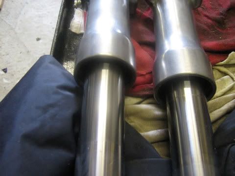

The fork legs. I still can't seperate these...  >:(

If your struggling to undo the slider retaining bolt that threads up into the fork leg from the spindle clamp, I've found a cheap alternative to the custom tool Honda want you to buy is a wooden broom handle. Stuff it down the fork leg with a bit of gusto and hopefully it will offer enough grip to the nut end for you to undo the bolt. Best of luck.

Alternatively stick the chisel end of a wrecking bar down with the fork compressed and engage with the top of the damper rod, then use a good quality 3/8 drive allen key onto the allen bolt in the base. Works on Marzzochi' every time. If really bad, try an electric impact drill or air gun to spin it off. All the best.

I've managed to undo the bottom bolt up inside the fork leg, but I still can't seperate the leg from the tube...  >:(

Apparently not. The workshop manual says to slide the tube out sharply: the bushing thereon will drive the bushing and seal out of the slider.

Hi, in that case put the fork leg in a vice,with something to protect the chrome, apply heat to the area around the bushing and push the slider up as far as it will go and then yank it as hard as possible, rather like a slide hammer. Had a similar problem with some Commando forks and this method worked on them.

There's no circlip but there is a sprung wire clip thing jobbie behind the dust seal.

Got the fork legs apart, ordered some seals from David Silver so should be able to get the forks finished as soon as they arrive.
