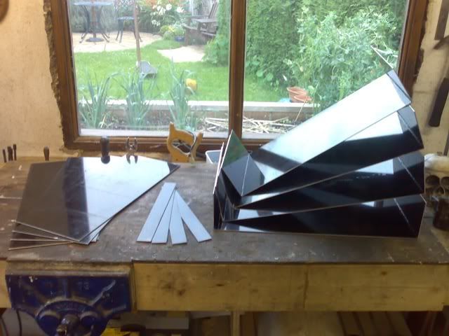

Latest project for Dolly. Marks will be awarded for comedy value :-)
Re: Can ya guess what it is yet???
« Reply #1 on: August 04, 2007, 09:27:20 AM »
Hey a window box for Dolly - currently being soak tested on the shed.
in the foreground some filing trays
« Reply #2 on: August 04, 2007, 01:23:02 PM »
Goodness,hes making hard panniers for it.Sorry HER !
More like Tupper Ware....methinks !
« Reply #3 on: August 04, 2007, 04:34:28 PM »
Well done 002, the Acme-squirrel self assembly pannier kit project is underway :-) Had a contact from work cut/bend the ali sheet and I've bought some angle from CG rees. Add some stolen screws & whiz tights and hey presto home made panniers :-)
So far I've joined the two halves together to form the sides and am off to get a desent mitre block to cut my angle edging. Will post more piccies as things develop, cheers.
Bruce

GUess you could take a look at some of the metal box panniers that are about for inspiration - although I have seen ex-service ammo boxes and the like used too - waterproof if not a little heavy.  ANy ideas about the frames and the fixings?
« Reply #8 on: August 07, 2007, 04:40:16 PM »
Already have the frames on the bike. I made them earlier in the year with the help of SteveH who did the welding. As for fixings, I'm going 'simple' as it fits my mentality and the panniers will bolt directly to the frame at 3 points. I plan to pass the bolt through the pannier from the inside out and lock it in place with two nuts which will act as spacers between pannier and frame.(something that's required cos when I made the frames I made them 10mm too narrow to clear the indicators. Oops) this should allow me to pass the remaining bolt through the frame and secure with a nylock nut.
The bit I'm puzzled by at the moment is how to fix the lid without welding. If I hinge them with the bolts poking out then the nuts could be undone, if I go the other way then the nuts will foul the box :-? Heyho, the fun of being an inventor.
Bruce

Perhaps you could use pop riviets or similar
« Reply #10 on: August 07, 2007, 11:13:00 PM »
pop or ordinary rivets.  Can you get snap off bolts in the size you want? - mind a bugger to undo.  Standard nuts trim off surplus and centre pop - reduces chances of being undone, ditto but with super glue or araldite.  Dome nuts on the inside.  Turn some standard nuts down on a lathe until a snap on tools surface drive socket will grip but not a standard spanner.  Glue.
For sealing them http://www.polymax.co.uk/ do nitrex and silicone section that could do the job - but they have a minimum order of £10.  However I have a couple of quids worth I want from them so maybe we could team up if you want some section.
