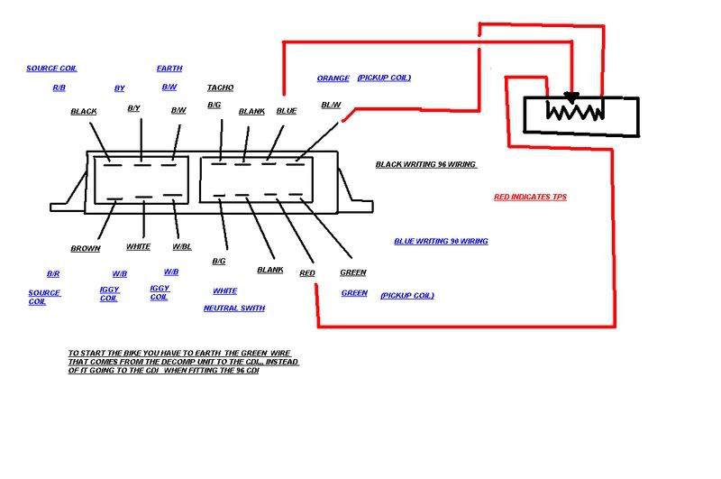

Hi Dave  thanks for your reply, Its a 89 dr 750 motor with a 90 dr 800 stator fitted with a  96 dr 800 cdi unit . The 89 >90 750/800 motors are the same apart from 6 mm on the stroke ,91 models 0nwards are different  ,fitting the 96 cdi was so easy it has just 2 wires more to incorparate the tps that i aint got ,I just took the connectors out of the blocks on the loom  and with the 2 diagrams placed them onto the new cdi , had to earth a green wire to let the decomp switch working with the cdi , then bingo it fired , Ive just been informed that the 96 motors had the key way altered on the flywheel aparently so that would mean that the timing would be to advanced or to retarded ,Ive yet to find this out ,I put a strobe on the bike today  and it was firing right on tdc and it was advancing after 2000  rpm but then all the bike did was struggle and backfire through the carbs  like i say 2000 rpm then it goes proper pants ,Not to sure about this but i might have a go at oveling the pickup coil holes and see iff it makes a difference on timing by moving it either way ,it seems to me that when it back fires through the carbs that the timing is too advanced thus explaining the keyway change on the later models hopefully to match the later cdi ,Ive done all the pickup and source coil ohm readings and they seem both to manual spec ,even visual they look ok.

I tried the tps bodge up with a guitar pot wired off the diagram ,made no difference and i have tried a working cdi off a dr 750 the same as origonal one i have got that goes with the stator ,but that wont work either  it could be pickup coil even though the ohms readings are reading correct ,im really greatful for your or anybodys advice ,iff you think of other stuff to help out im all ears ,,,cheers Rory

im in Redcar , cleveland  Dave . I put a strobe light on the bike and the spark starts to go mad and  starts missing soon as the advance reaches its limmit so there is something that might be a clue to whats going on ,
this is what i did to get the  90 dr750 to run with the dr 800 96 cdi
