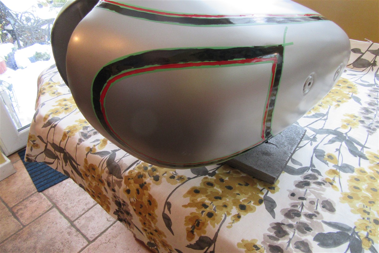

Nice video (apart from the irritating sound track). I used a similar technique for lining my Norton tank although in reverse to his method as I was using coachlining paint (one-shot) applied with a brush.
Masked:
And finished:
Re: XBR replacement tank
« Reply #113 on: September 14, 2020, 02:57:37 PM »
Very nicely done!
