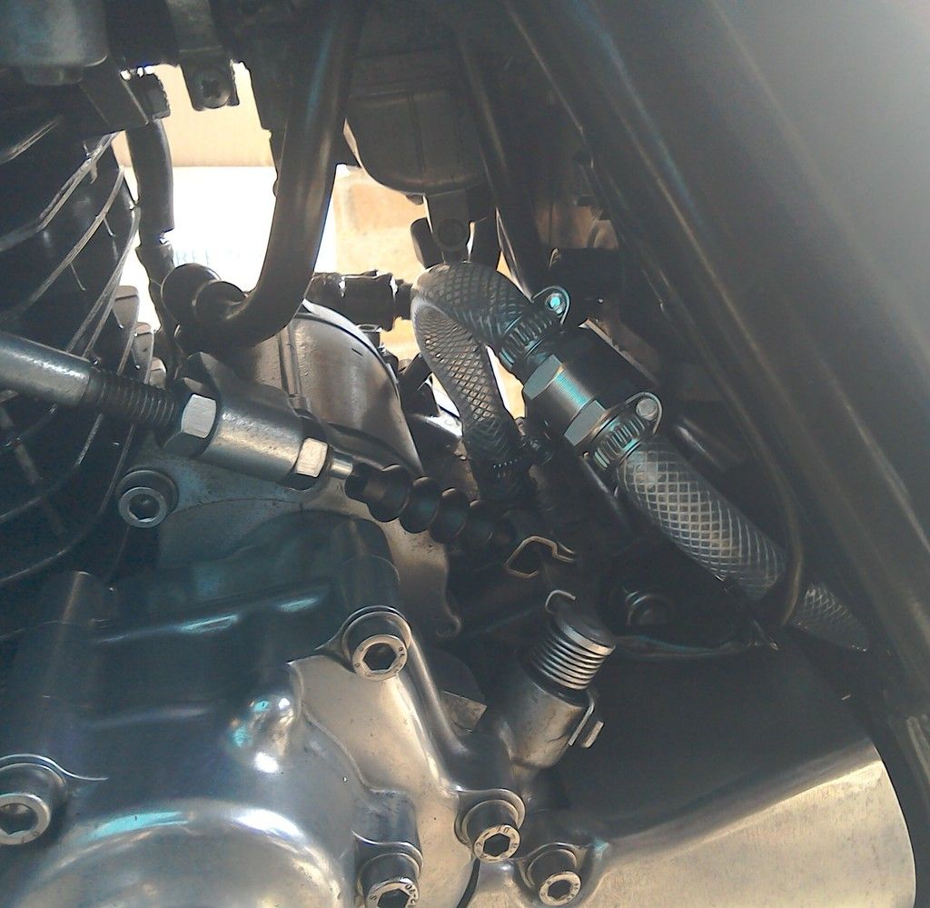

Joolz, will the slight flattening of the hose still allow sufficient venting? It's not kinked like a garden hose when there's no flow at all. I have no idea about tolerances. Please swipe/drag pic to the left to see it all. Must get an app to allow me to resize.

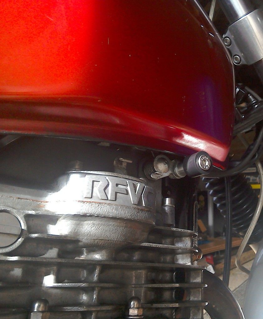

Here's another small mod I copied (from an LS650) to see how it goes before reinstalling onethecheap's original decompression setup. I might keep it if doesn't get too hot ( or melt!) as I prefer to avoid cabling where I can. I also prefer manual to automatic operation in general, when possible.

That hose should be ok, it doesnt matter too much if its a bit flattened as long as the air can escape ok. I have a similar decompressor mod, manual control is always best

Good to have you "looking over my shoulder" as it were. Much appreciated.

Have you given the bike a ride yet, how is the one way valve working out

Hopefully today, but just a few miles to set the oil level after the oil & filter change. Lovely day here 14 deg C! I'll post after a decent ride to update you, but I think my main loss is coming out at the uppermost valve cover bolt, so I think I'm right in saying the revised breather setup won't affect this?

It should stop most of that oil leak, look forward to hearing how the ride went. Have fun

Ride was today. Only 20 miles, but keeping it mostly between 4 and 6k and occasionally above that to overtake. No signs of oil from the top rocker cover bolt, so I reckon you've provided me with a permanent fix, Joolz, for which I'm very grateful.
