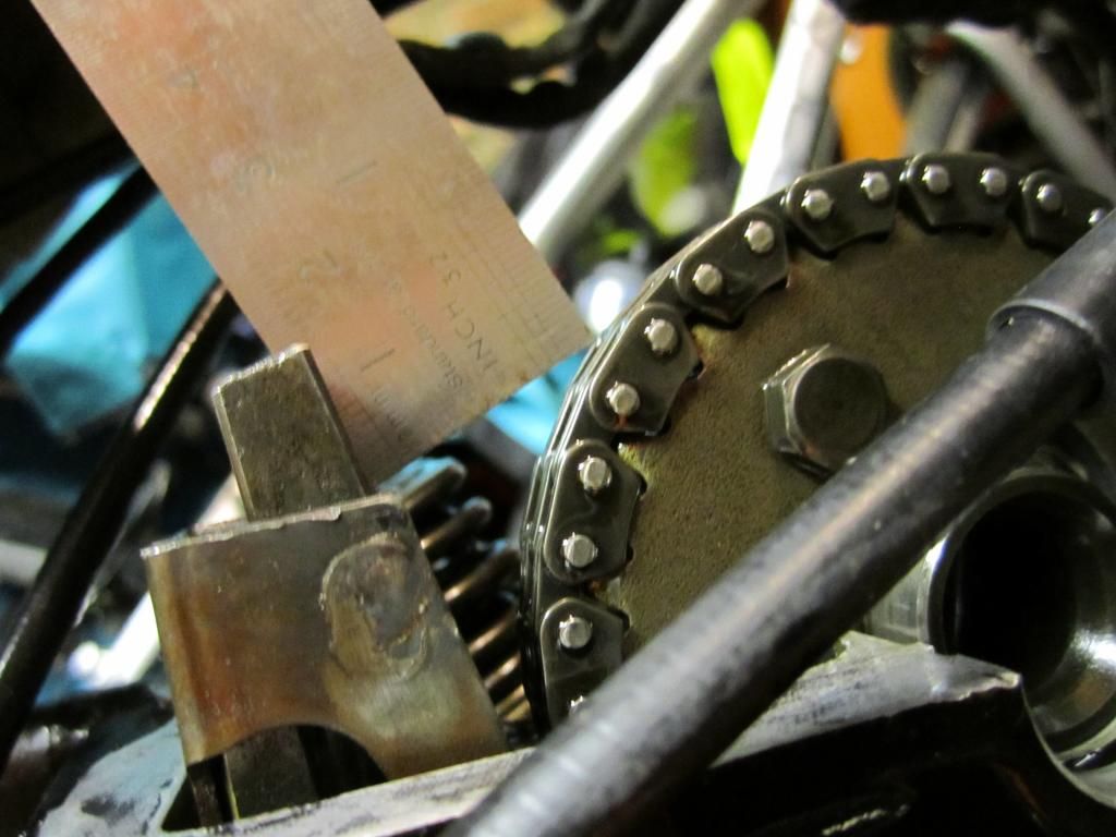

Had this CB250RS running briefly, it died in the Galloway hills. It's since been in the garage 4 years. Finally had a wee look...

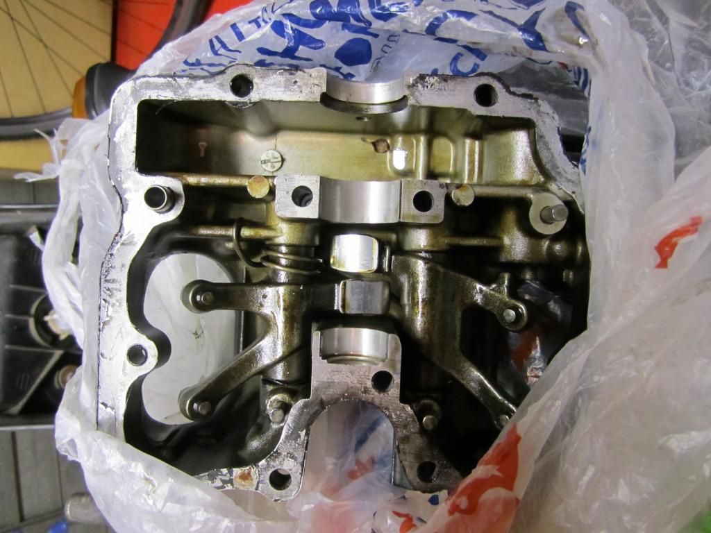

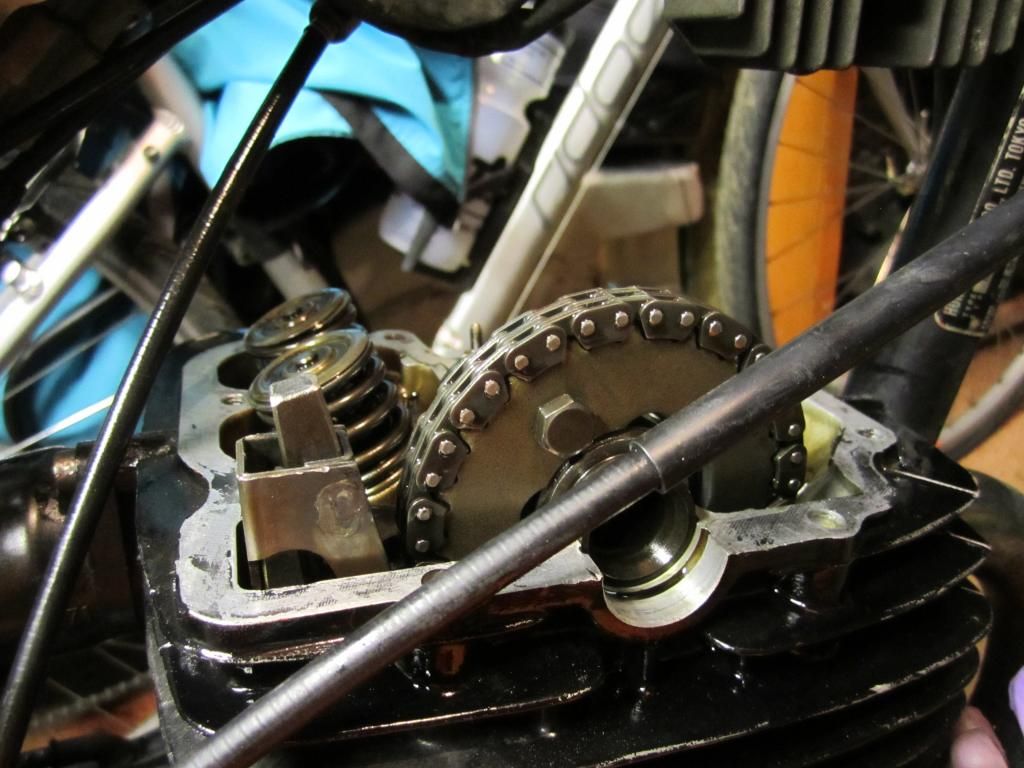

Rocker box off shows very worn camchain (wedge shouldn't stick out more than 8mm, or be shiny where it's hitting the engine cover. Ahem). I'd done tappets, then ignored the loud tapping still present - well, it was a pretty rough bike!

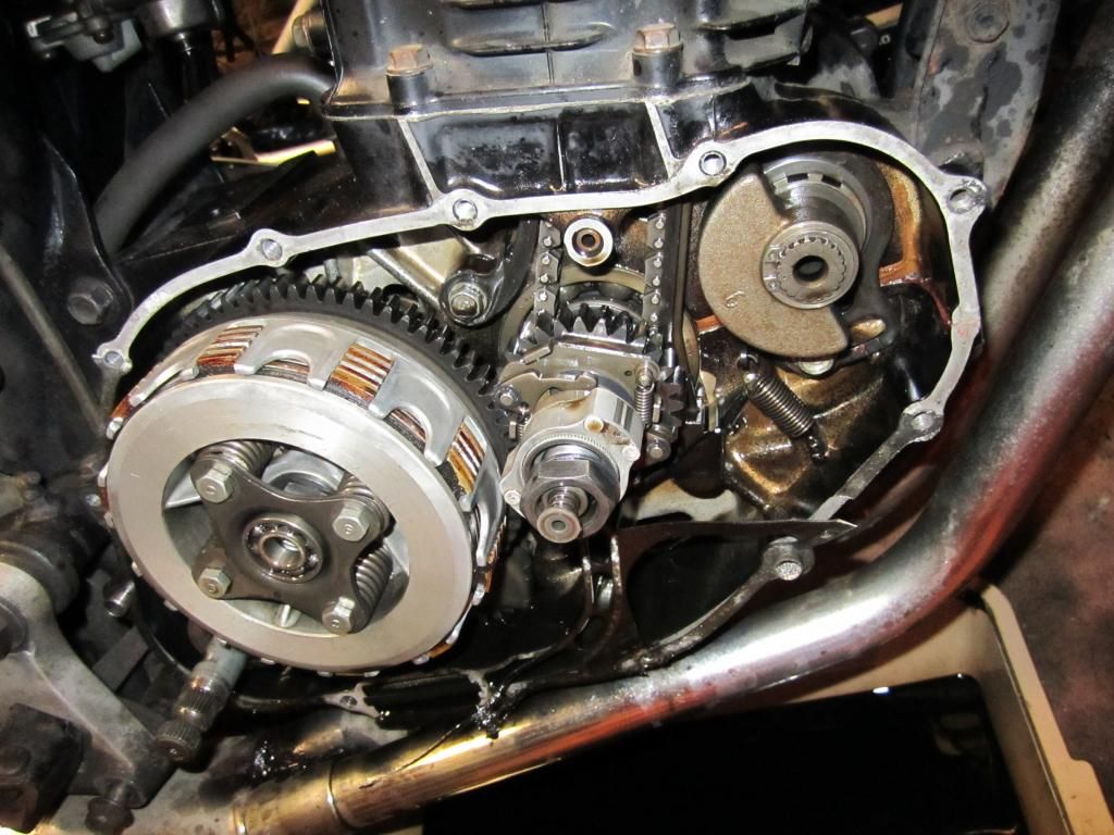

Camchain is VERY DEAR (£50ish!), took off side cover with view to checking tensioner damage, metal flakes, etc, and found this:

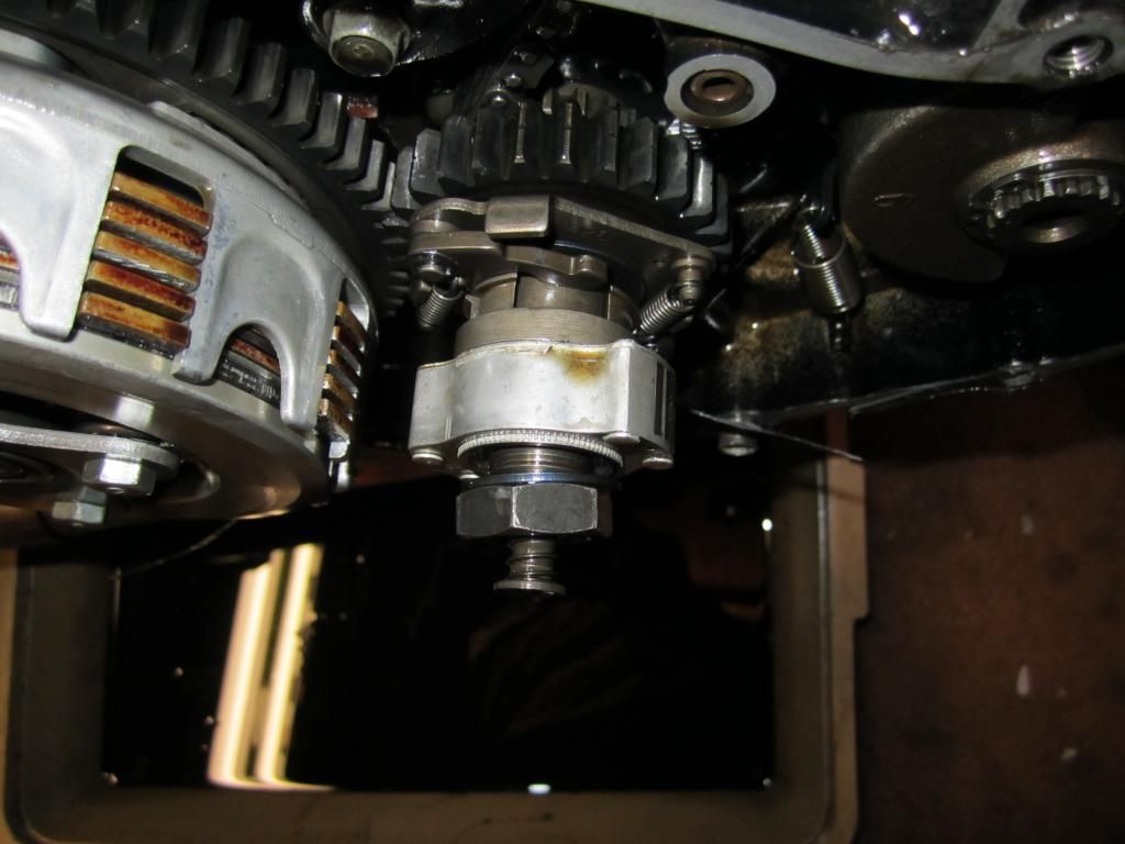

Big nut holding on ATU (pulsar, and mech advance) has undone itself, only held on by engine cover! As a result, pulsar senser bit has popped out of engagement with arms/springs of baseplate - no wonder it wouldn't run!
Amazingly, nothing seems damaged! I'll put it back together roughly without changing camchain, just to see if it runs now - if so, it's worth camchain (also a bit of work on carb - butchered by P.O. I hasten to add. I've fixed accelarator, and a couple of other bits, but it leaks a bit).

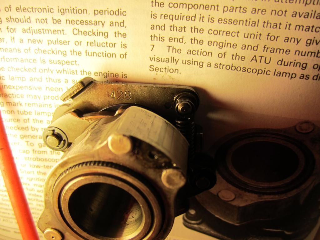

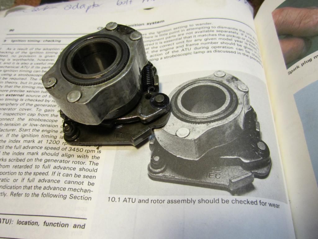

The pulsar senser bit (the oval bit at the front) will fit into the baseplate 2 ways, 180 degrees apart (it could be worse). I think these photos show it assembled correctly - but tell me if you know better!
The baseplate has TEC stamped at 6 o'clock, and 428 stamped at 12 o'clock. The oval spinny bit has ONE END with a magnet (?) in it (2 vertical strips) - I think it's the end NOT visible in the Haynes book photo, nor the photo above as I've assembled it, where magnet strip is at about 2 o'clock.
Photo below shows magnet strip
Final evidence is in photo below, B stamped in non-magnet end, dirty patch in magnet end...as per Haynes photo.[/quote]

I don't think it makes any difference which way the a/r unit fits as it runs at engine speed and there is always a 'spare' spark on the exhaust stroke. Regarding the cam chain tensioner, I've got two engines and on both of them the protruding piece at the top actually touches the cam cover to no detriment to the motor. You can change the chain if you fancy it but if so the tensioner ought to be replaced too, the possible cost assuming that you can get a new one of both will be in the region of £90/100. Personally I wouldn't bother. Best of luck.

The wasted  spark refers to the spark on the exhaust stroke. The assembly of the AR unit is important otherwise you will have a spark at the bottom of the stroke rather than the top. To be certain I would put the piston at TDC and make sure the magnet on the AR unit is pointing towards the sensor (from memory its inside the casing)

Dont leave the camchain slack, it will wear through the camchain tunnel or it will jump a tooth and put a valve through the piston.
Endless chains are about £35 and you only need to replace the tensioner if its excessively grooved. These bikes are excellent little machines and can go for years if regularly maintained, I had one once with 68000 miles on it, and the first one I had hit 96mph
