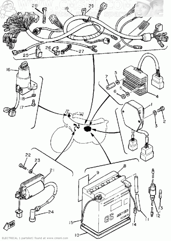

That looks like an ignition coil to me. If that is connected directly to the alternator then you have a CDI. No points or condenser.
Does this look like your setup? Its from a 1980 SR500G
The CDI unit is part no. 1 in the image. I'm not really helping, am I.
I'll get my coat...
Dave B
