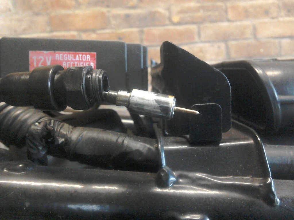

The XBR plug is black & sooty after only 160 miles. In repeatedly rerouting cables recently, I noticed the thread on the plastic choke valve is knackered. The weight of the cable keeps it slightly tilted back, about 1 mm off its seat. Also, the needle itself seems worn?

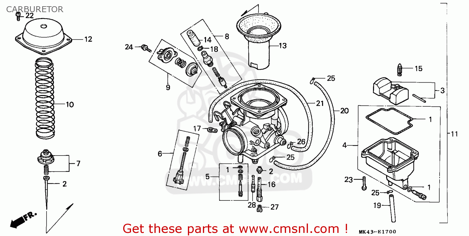

Yes there should be a spring - I don't think it has a particular tension so something from a box of mixed springs from a hardware/ auto parts shop should provide something to do the job. (parts 14/18 & below)

The spring was absent, having pingged across the garage. It must have entered a tear in the space/time continuum fabric because it reappeared later in the middle of the garage floor, after I had systematically removed and replaced every single blessed item, looking for it... Grrr!

So is the knackered thread and/or worn needle a possible source of the bikes rich mix?

I don't think the needle is worn - that step is normal if that's what you're looking at.
