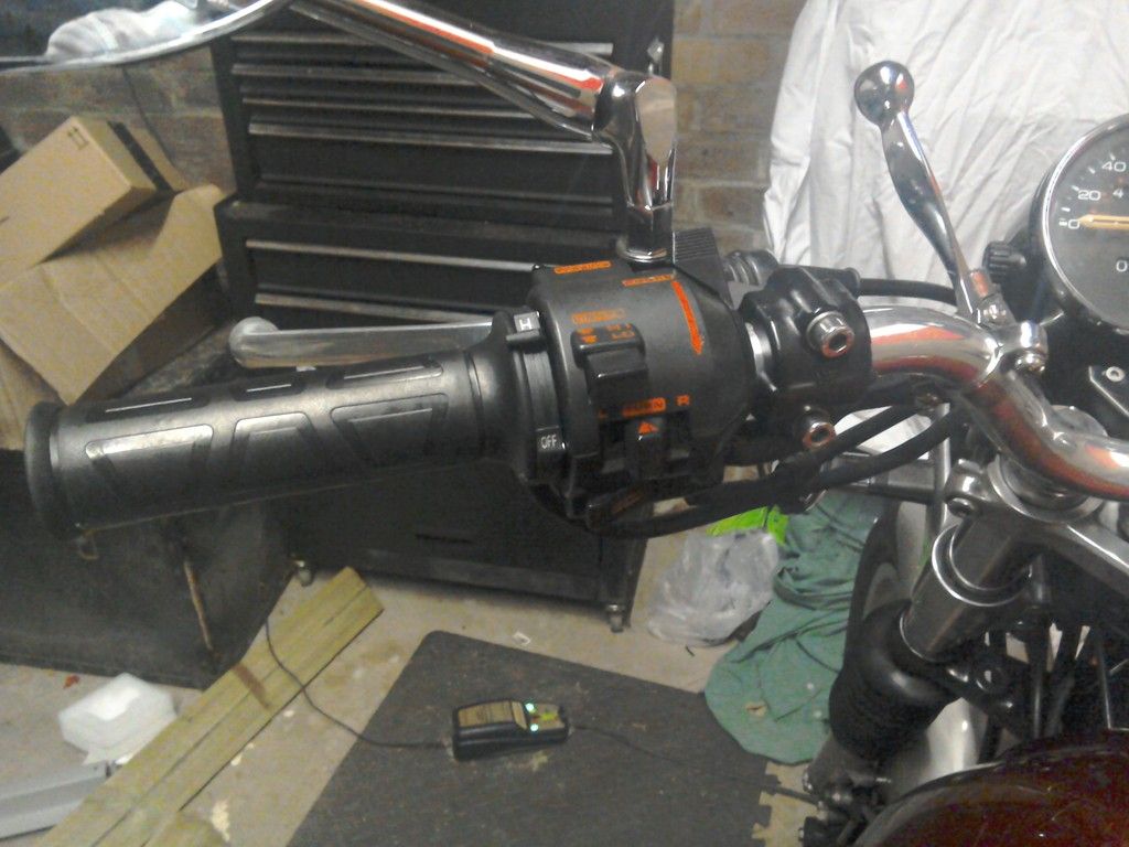

Installed Amazon cheapie heated grips today, courtesy of YouTube instructional video for additional fuse and relay;
Only hiccup was my splicing the switched live to the rear brake light, which would have made getting warm hands a bit interesting! 😱 Throttle tube plastic cable guide needed shaving at its end on diameter and thickness where it enters the switchgear housing.

Good job with the grips Mat. Get a pair of muffs for over them, and you'll be well toasty. Certainly saved my bacon last weekend, when the only warm part of me, was my hands  :-\
