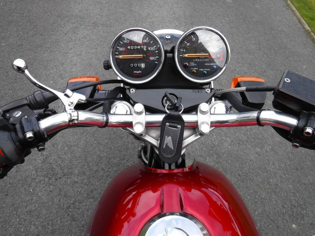

Not a great picture but from the top of the yolk to the top of the fork nut is approx 50mm.

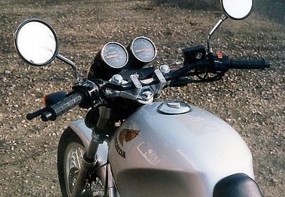

Cheers for that reference pic - very useful. I'm considering redrilling the top yolk to move the risers back to give clearance for my tubes to come up past the bar (see 1st pic of LSL kit) Then a clubman bar would transfer weight over the front like the original clip ons, whilst allowing me to retain the decompressor lever on the bar.

Hey Matt, if you fancy leaving your bars as they are, how about fitting something like these...bit pricey but may be of use?
Happy five-o by the way  ;)
http://www.ebay.co.uk/itm/262305743789?_trksid=p2060353.m1438.l2649&ssPageName=STRK%3AMEBIDX%3AIT

Nice! I'll see if there's room on the top clamp to reposition the existing risers so that the tubes aren't obstructed by the bar and blank off the old hole. If not, you've got the solution - thanks. 50?! Still trying to get my head around that particular number!
At least 6mm out, so no chance of reusing the existing risers on that top yoke. Looks like I'll be asking for a late birthday pressie on top of the new tyre.
