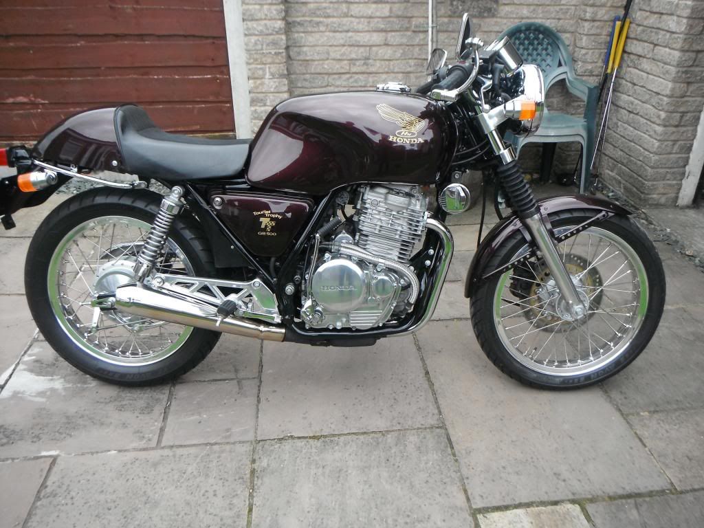

This was my mates GB before the tank went away
