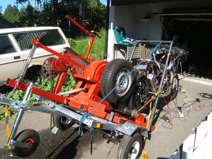

Its a water turbine paddle wheel. the bike back wheel sits on the rollers and up against the car wheel, the bike spins the car wheel, which , when water is applied to the turbine house, applies a force on the 1 meter long arm , which presses down on the load cell, which displays kilos on the digital scales. so this kilos reading is multiplied by the engine revs and gives a figure.
for example 11.5 kilos x 7000 rpm:- i dont bother about the three zeroes, so 11.5 x 7 = 80.5
if i tweak something and it becomes 11.6 kilos, or 7050 rpm , then it is on the correct path of adjustment.
calculations or fiddle figures arent necessary for seeing if the power increases or decreases when adjusting fuel or timing - i am happy if i see the scales or revs increasing when i adjust something.
I have just put together a logger which can be plugged into the computer, but otherwise its just as easy to use a video camera sighted on the scales and revcounter if some logging is desired.
the water doesnt cost so much, and can even be returned to a header tank if i had one. Mind you , it will boil after prolonged running as heat is generated.
I can also bolt on a seperate engine and run with a chain to the sprocket if i wish to bolt it onto the turbine shaft. at the moment the sprocket is just hanging so i dont get tangled up in it.

Makes sense, I seem to remember using something similar in my final year to measure the output of a steam power plant. Did you build this yourself ?
guest1306
Re: Supermono 1300cc racer project.
« Reply #62 on: April 24, 2014, 09:01:03 PM »
Original H. P. Andersen. Danish brakebench which takes up to 350 hp. i totally renovated her- was in a sorry state, then built on the rolling bed and car wheel.

Cheers Joolz, ive had a nice weekend running my old Hybrid on my brakebench. It pressed 12 kilos at engine 7460 rpm
« Reply #73 on: September 01, 2014, 08:09:40 PM »
Bike looks good. Would love to hear it.
Put me right here, that's 120 Nm? Just shy of 90 lbft?
That'll be the torque at the turbine? Assuming I'm on the right lines here, what speed is the turbine doing?
The rolling diameters of turbine tyre and bike tyre look similar. How much slip?
Great stuff.
guest1306
« Reply #74 on: September 01, 2014, 08:16:10 PM »
yes thats the turbine torque, when running in top gear on the bike. absolutely no slip, she is ratcheted down good and hard.
didnt think about recording the turbine revs, too much panic, so i must work it out the hard way.
