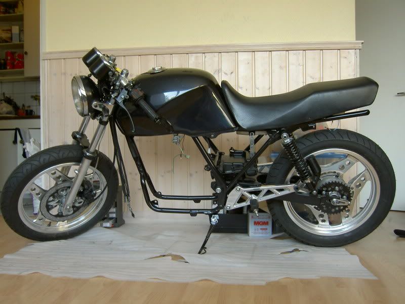

With my current work assignment keeping me busy and apart from my bike in another city, the bike is progressing slowly. I'm so driven to make this bike run soon that I've decided to concentrate on the details next summer and just get the bike on the road ASAP.
As of yesterday, the bike is a roller!
I've decided to use the old seat for now, I hate the way it looks but it'll have to do for this season. Almost everything is on the bike besides the engine, exhaust pipes and some tubing.

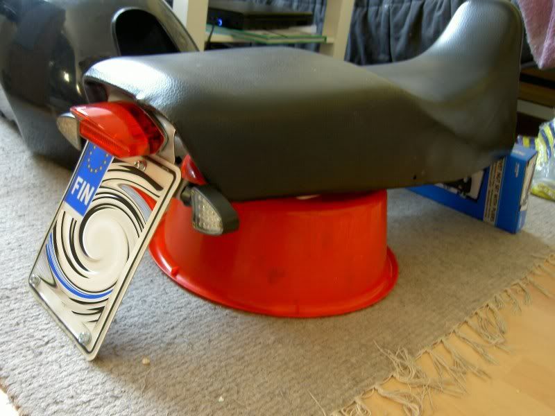

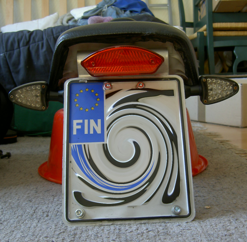

I've also fabricated a quick temporary bracket to mount my new LED taillight, indicators and license plate to the old XBR seat. It looks... hasty, but it should do the job. It will be attached to the seat by using rivet nuts - as soon as I can find a rivet nut gun that handles metric 8mm threads..

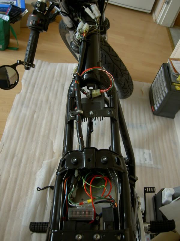

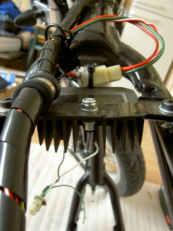

The regulator/rectifier is turned upside down and oriented so the wind will pass in between them better.

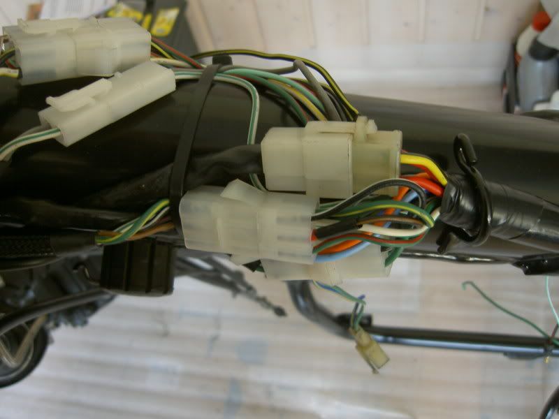

The wiring loom didn't turn out as good as I'd hoped. The reason being my anxiousness getting the best of me and also I made a few mistakes on my wiring diagram. But the good news is, everything mostly works! Mostly being, the taillight warning light won't turn off although the tail light works fine. It was this way also when I bought the bike. Don't know if the brake and taillight sensor is faulty, is there something wrong with the loom or if the sensor just doesn't work with LED. Either way, it's no biggie. I also had to give up the rear brake light switch. I had a relly nice bracket made for it but the oil tank blocked the direct route to the pedal, so that'll mote to the to-do-list.

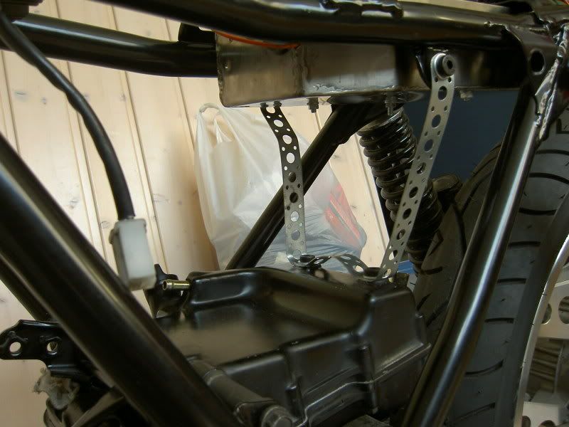

I ghetto-mounted the oil tank using just regular steel band you'd find on any hardware store. It's ugly, but does it's job.

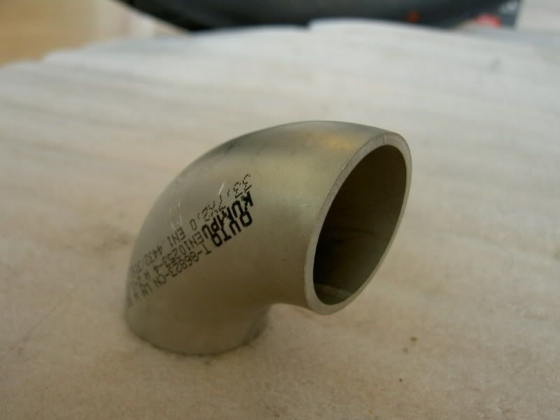

Here's a quick teaser pic on what I'm going to do with the exhaust next winter:
I'm planning on fabricating a 2-to-1 all stainless free flowing exhaust on the bike. I measured the diameter of the exhaust ports on the engine (30mm) and am going to use the same inner diameter on the header pipes (ID 29,7mm), which will then unite in to a 2" single tube, followed by a 2" free flowing muffler. It will be short compact and noisy but that project will have to wait until next season.

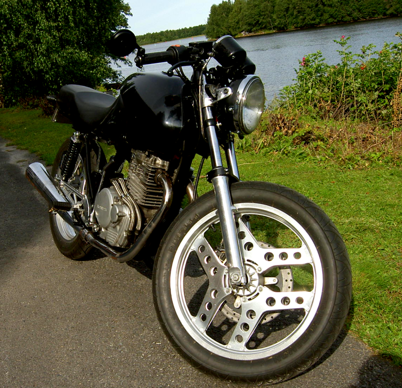

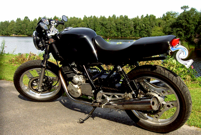

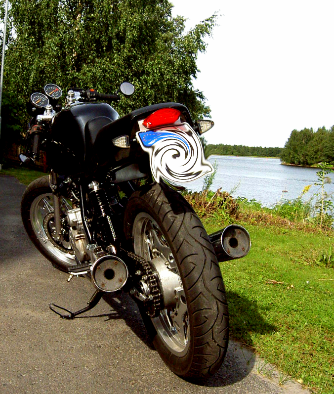

Here a few quick photos of the first reincarnation of my XBR - it's not completed, but driveable.
