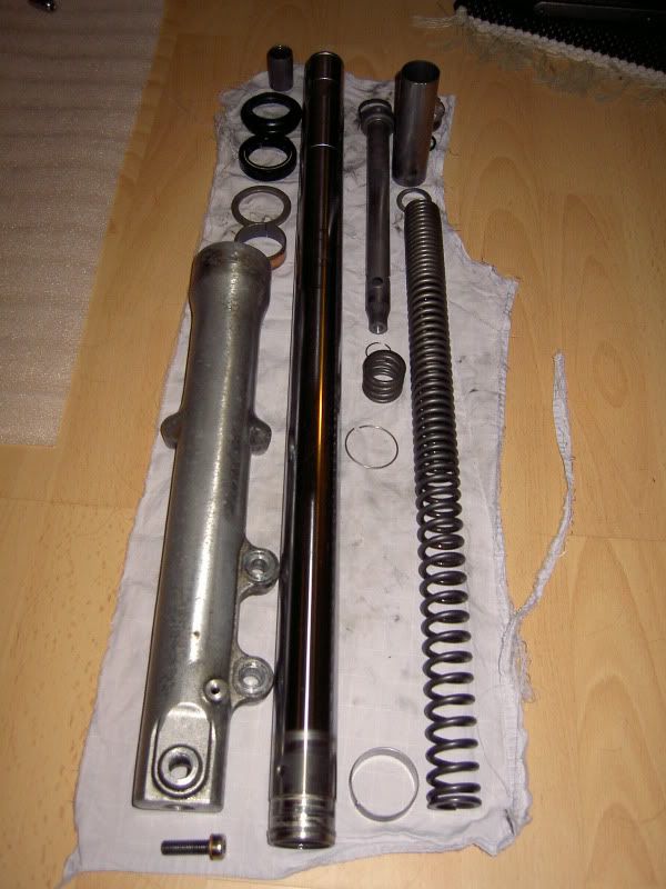

Anyways, here's one forkleg disassemblied. Someone has previously been here, since the oil seal had been shredded with snapring pliers, and the snapring was missing. The copper bushing showed copper from each side, hence according to the manual, it's time for a change. I still think the bushing is good to go, I'll just replace the oilseals and the dustseals.
Does anyone have an opinion about WeMoto.com? I was thinking about ordering the seals from there.

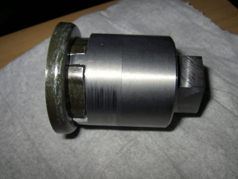

I measured the left fork tube for straightness and it checked out. 0.045 mm bend, which is still way within the service limit of 0.2 mm. I also cleaned the chain, since I'm not going to replace it nor the sprockets.
And here's a nice little tool me and a friend at school made; it's a socket for tightening the steering bearings to their correct torque. It might be a bit too robust for such small amount of torque, but it'll do the job.

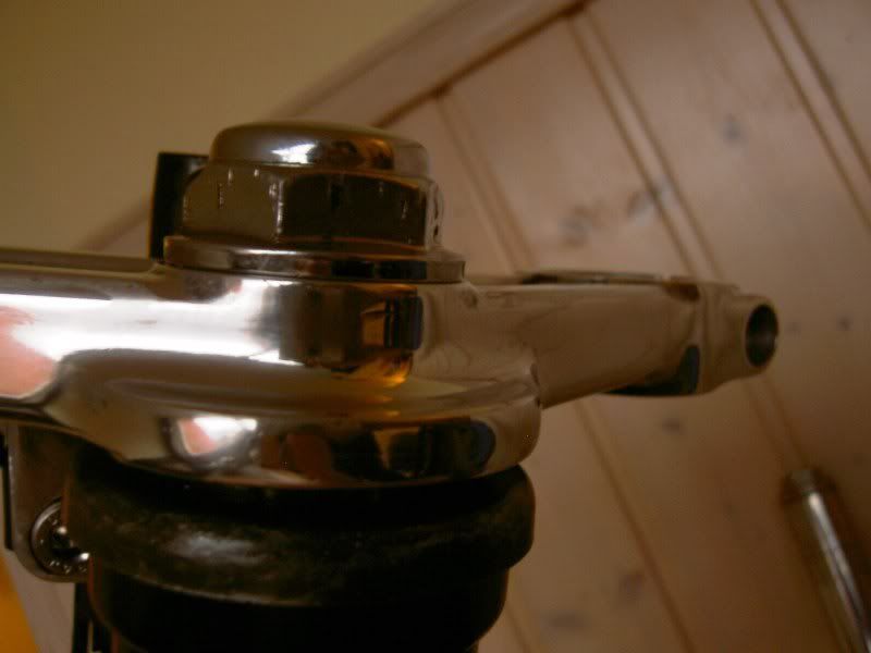

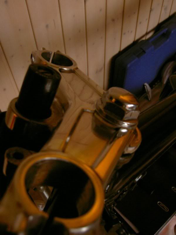

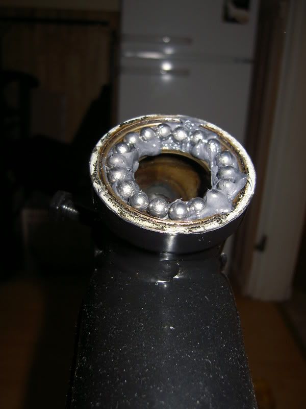

Some update: got the headrace bearings in place:
And here's the top yoke done. I know it's not totally mirror, but close enough.

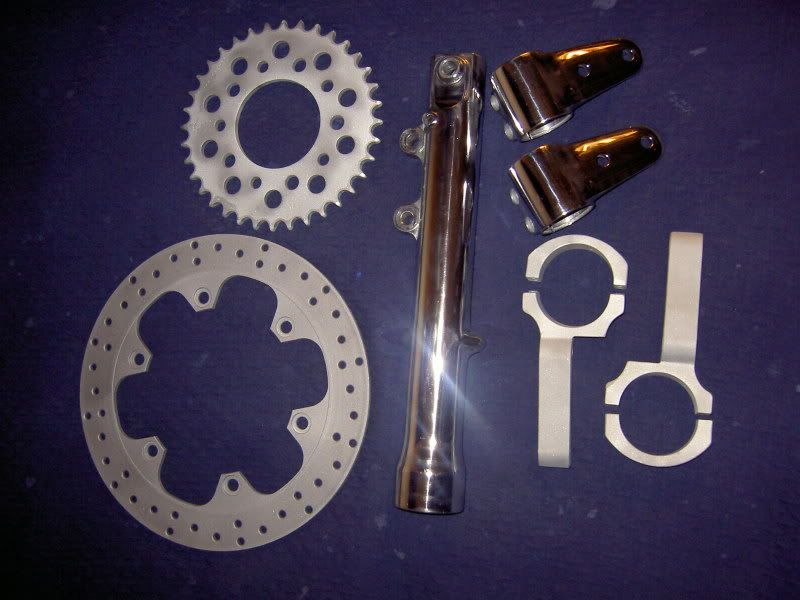

Here's a pic of some freshly blasted/polished 25 year old parts:
The fork braces and the rear sprocket will be painted black using just plain aerosole. The front disk will get some heat resistant black on it. The polished fork tube is a disaster - I don't like the look and hence didn't bother being too picky with the end result, but now I need to polish the other one too. I might end up painting them next year. The headlight brackets turned out beautiful - I shortened them about 20-30mm to get the headlight tucked a bit more closer to the forks and also drilled holes for the LED front blinkers.
