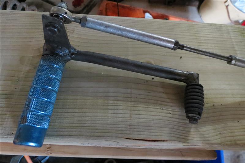

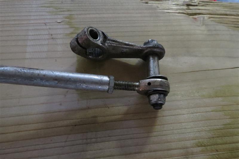

guest564
The linkage that I made was rather crude, just made from bits that were lying around, I made some hanger plates from ally and used ally pegs with the one on the left hand side turned down for the linkage to pivot on.
I don't recall what bike the splined part come from - it may have been an old CB900 linkage. The part the rubber fits on is an old SS50 rocker shaft, the rest was old bits of tube. The threaded parts came from some old rearsets. If you're keeping the stock footrests then you would need a different pivot. It may give you some ideas for something nicer looking anyway.
guest1796
Hi again,
Thx Rhinoman for the pictures. I need to make proper, a bit longer, test run to figure out more about riding position. And yeah... already driven about 1km with it :)
