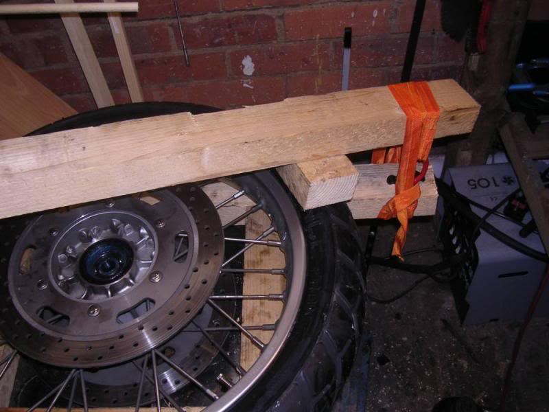

I've ordered the Mitas from Demon Tweeks in 3.50x18 size. Meanwhile have taken the old Roadrider off the front wheel. What a struggle! I had to use my home made bead breaker for the first time since making my Tiger wheels tubeless (below). The tyre was like iron, which is not surprising - when I looked at the date code it's 16 years old. I think it would have held the bike up with no air at all it was so stiff, and this probably contributed a lot to the shimmy problems. The task wasn't helped by the Akront flanged alloy rim, which seems to be deeper than the chrome rims I'm used to. Fortunately managed without nipping the tube or damaging the rim so am just waiting for the postie with my new tyre. I think there's room under the mudguard for it.....
I suppose I should now check the date code on the back tyre although it (and the front) wer performing fine when the bike was a solo. Although only in the dry of course. And I don't want to repeat that fight any time soon.
