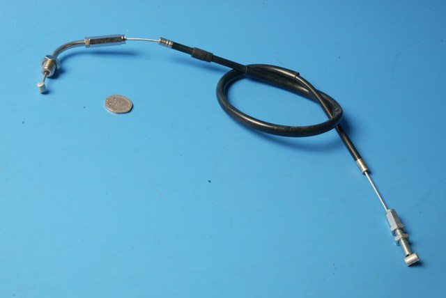

I've just checked my spare throttle cables. When you say there is no adjustment, do you mean there are no actual adjusters or that the adjuster at the throttle end is wound right up to the curved cable guide?  There should be about 15mm of adjustment at the throttle end and 25mm or more at the carb end. If the adjuster is wound right up at the throttle end ( as in the picture) then you'll have to disconnect the cable at the carb end as all of the slack must have been taken up there.

« Reply #6 on: December 11, 2011, 04:19:29 PM »
Good pic Steve...afraid so..at the throttle end its as tight as a gnats chuff as in picture, to ease the free play. At the other end by the carb there  doesn't seem to be anything to be gained. Original cables i believe. There must be a logical answer to a simple cable fit.Guess what i would like for Xmas... ::)
