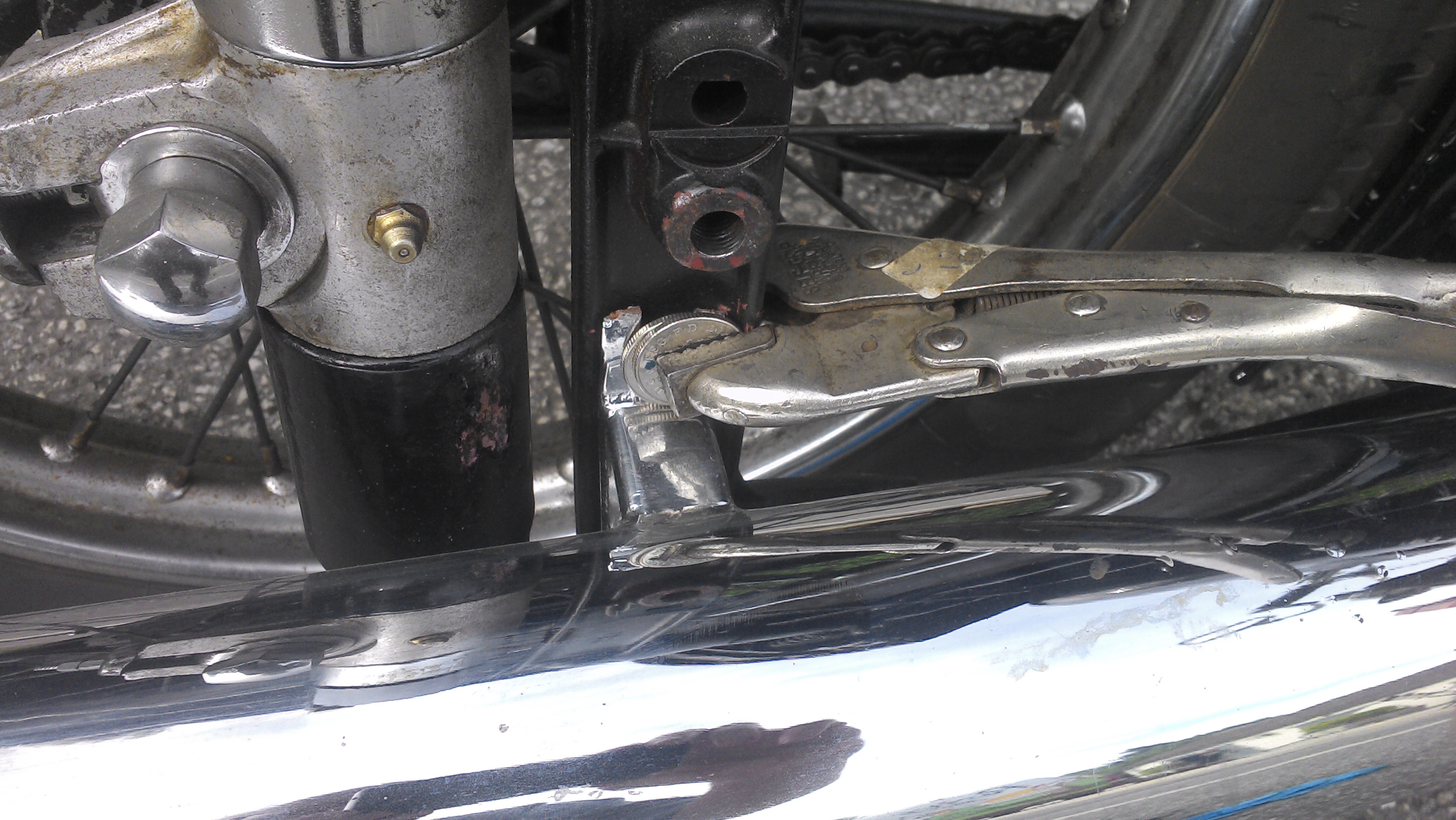

Out for a thrash on the ES2 this morning. Noticed it was popping a bit on the overrun – called in for a coffee and saw the silencer bracket had sheared and the whole weight of the pipe & silencer was hanging off the cylinder head thread….
A few minutes thought and I realised I could use the mole grips to clamp the remains to the frame using a couple of 10p pieces as spacers. Worked well for the 20 miles home.

   Good job that !    I think I still have some 1950`s shillings if you would like some to put in the spares box as `period` accessories ..
Re: 1001 uses for mole grips #375
« Reply #2 on: August 30, 2019, 01:21:50 PM »
Nice job Ian, at least you have the weather to go for a wee spin! Lashing it up here!  :(
Always have a pair of 'Mole-grips' in the tool kit. I have used them as a substitute gear lever and brake lever afore now.  ;)
« Reply #3 on: September 03, 2019, 10:51:03 PM »
An excellent road side repair  :D
