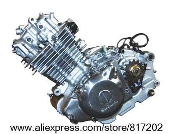

just found this place, 17T avaialable ! and according to gearing commander if i use a 17 front and 37 rear it should do 91mph at 7000 rpm, hopefully i will find out in the near future if this works in practice
http://www.aliexpress.com/store/product/Suzuki-27511-32401-ENGINE-SPROCKET-Front-Sprocket-GN250-SP250-SP350-SP400-SP500-16T-17T/817202_1592074332.html

You want to check that there is going to be enough clearance between a 17T sprocket + chain and the generator casing - I seem to remember from mine that there wasn't that much to spare and just 1 extra tooth is going to make the sprocket bigger than you might think. Don't go too high on the gearing or you'll kill the accelleration and make it feel gutless.

Well as suggested by a couple of you, there is barely any clearance for a bigger front sprocket, looks like i will keep gearing as it is !  thanks anyway...
