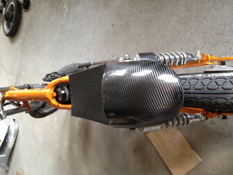

Didnt get much done last week as we were very busy with the cafe racer seats we sell, brought 3 new types out & selling loads.
Had another look at the carbon seat we made for this bike & it looks too wide at the back & a bit bulky too, so i got my lad who is an ace plug maker(does all ours) to make a seat plug especially for this bike he only had 1 day as he was needed to make seats that have been sold.
whilst he was doing that i prepped the tank for painting ready to make the moulds.
This is what we ended up with after a bit of black 2k paint. mould making started today.

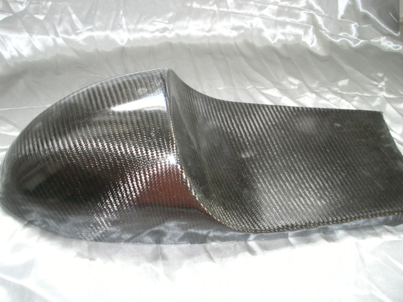

as to the seats we sell these in 3 options
1 straight from the mould - £59.95 inc uk delivery
2 painted in 2k gloss £89.95 inc del
or 3 carbon fibre £159.95 inc del
this is the one for this bike in carbon

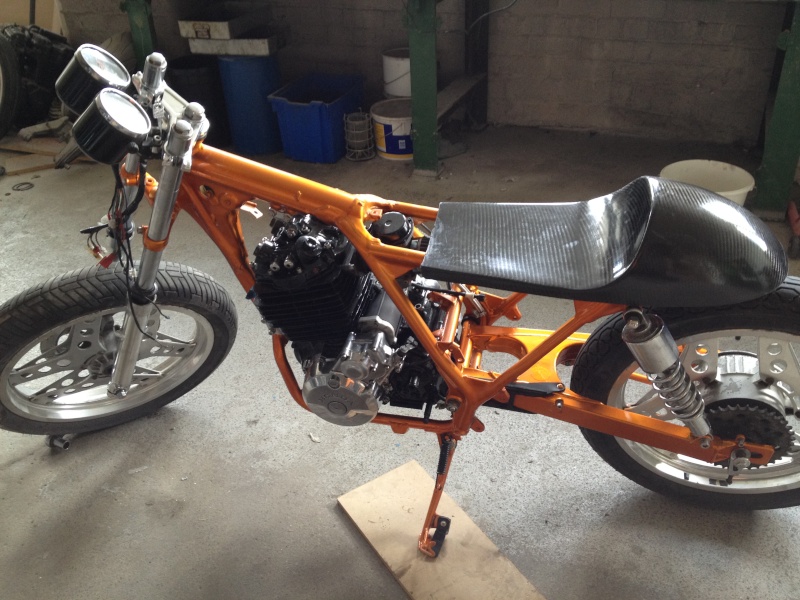

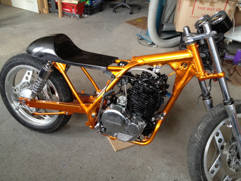

latest pics excuse the wheels the spokies are being rebuilt
