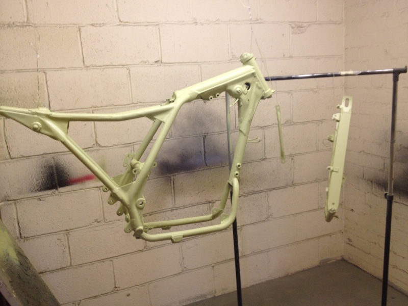

Got the frame acid etched primed & high build primed, not happy with a few imperfections in the finish so a bit more filling & flatting required before getting the base coat on.
Had another play with the front end with the spoked wheel & looked up & measured various discs to suit the rs wheel, found an old cb900f disc we had kicking around & it fitted & lined up perfectly, might have to machine 2mm of the caliper mounting bracket

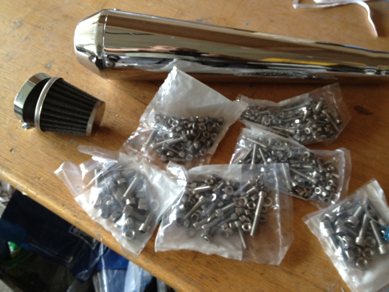

We have had a few new parts delivered, stainless bolts, k n style air filter & exhaust.

then managed to get the frame, swinging arm, side stand & torque arm in bright base coat silver, tomorrow the frame & swinging arm will get the candy applied & finished in top coat.
the engine has been stripped of its covers( which are at the polishers) the whole lot has been de greased  & wire brushed, the rocker cover has been cleaned & lightly polished. the rest inc crank cases have been painted in gloss black engine enamel. all the bolts nuts etc have been replaced with stainless allen bolts
