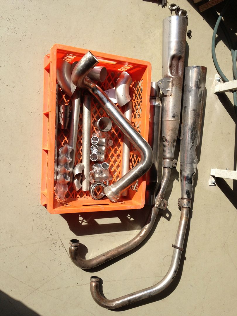

Project: exhaust.
This morning I woke up at 7 and took an 80 km ride on the XBR to a friend's garage to start making the custom exhaust on the bike. The plan was to get the pipe tacked together and finish off the welds later. We ended up finishing the system in a single day - a bit unpolished but functional. My friend TJV is an excellent welder and my role was his handyman, involved in the grindings, fittings and planning - the project was a success thanks to him.
The basic idea was to make a short, 2-in-1 all stainless all free flowing exhaust. I had previously turned two stainless header outlets on the lathe and acquired a miscellaneous selection of stainless pipes, cones and angles. The muffler I bought was a 2" free flowing car muffler, so it was expected to be loud. Here's where we started:

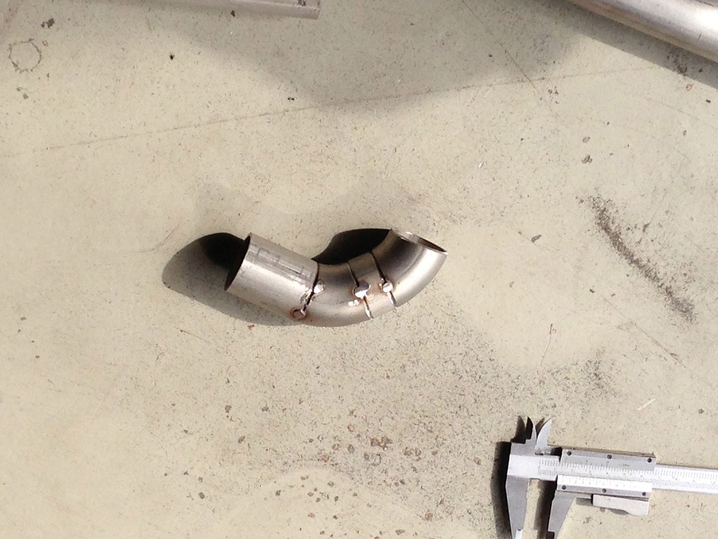

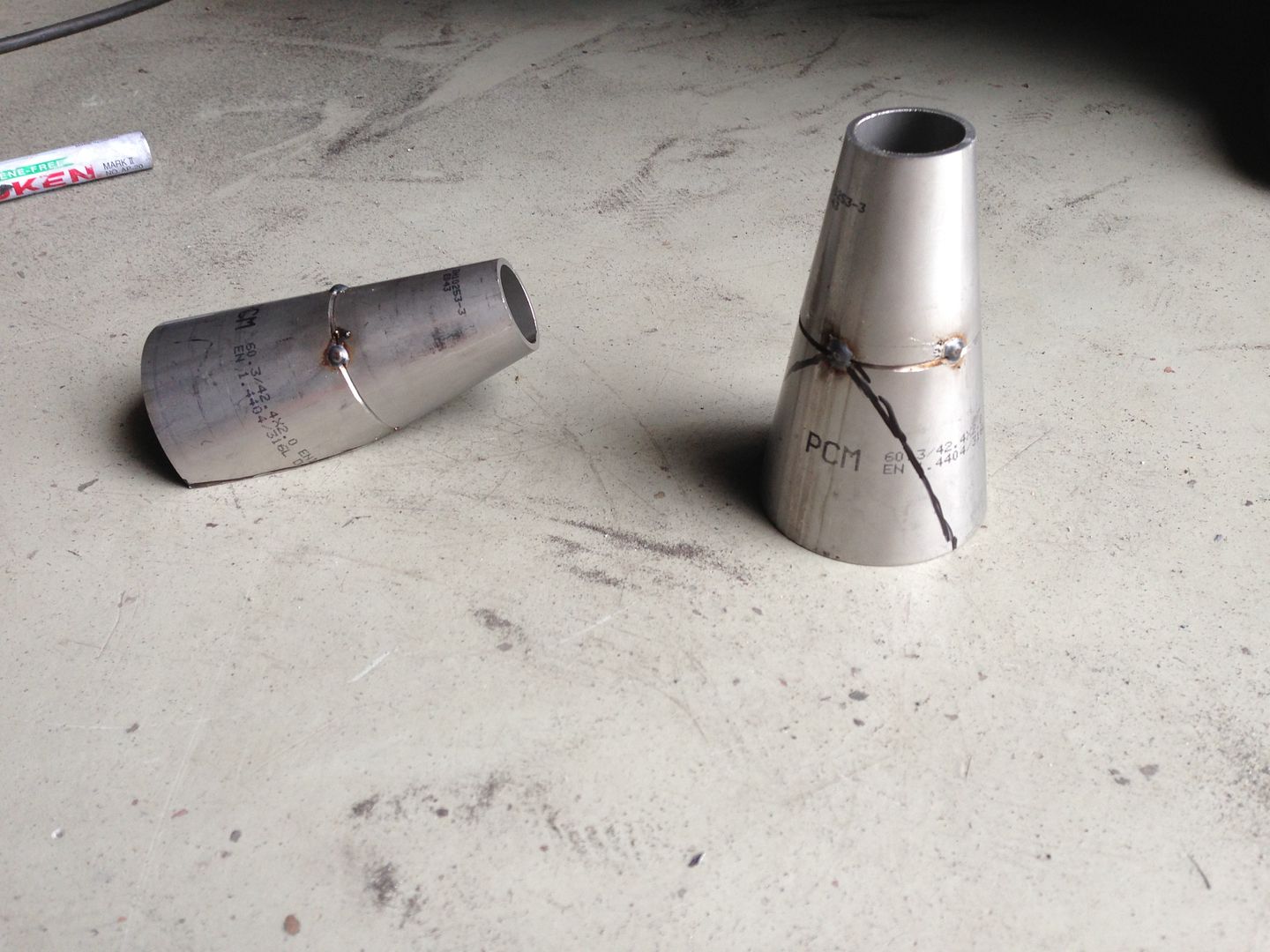

First we made the header section, which was to be connected to the muffler via v-band because I wanted the option to easily change the muffler without taking the whole system off the bike. The header section consisted of two 29,7 mm inner diameter tubes that would join together into a 2" diameter single tube. The tricky part was to make the diameter transition seamless for best flow characteristics. We ended up doing the 2-in-1 piece using stainless cones.
