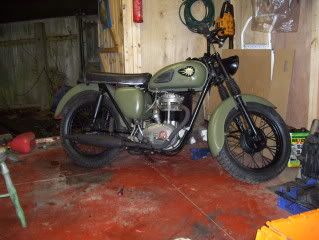

KungFooBob
Re: XBR Race Bike
« Reply #4 on: April 05, 2009, 05:49:17 PM »
Sorry about the quality, it's also far from finished, but you get the idea...
Still needs number boards and a few other bits and bobs to make it race legal.
