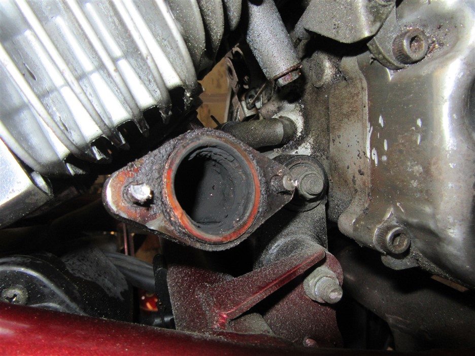

What a carry-n! I eventually managed to drill the head off the upper Allen screw but the bottom one was as hard as the bobs of hell. Eventually I resorted to a thin cutting disc in the Dremel and managed to cut the head off and release the exhaust.
This is what remains: a moot point as to how to remove the remains of the screws but I'll leave that for another day.

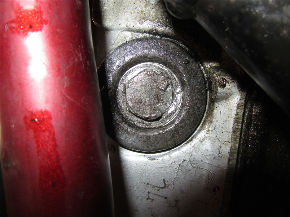

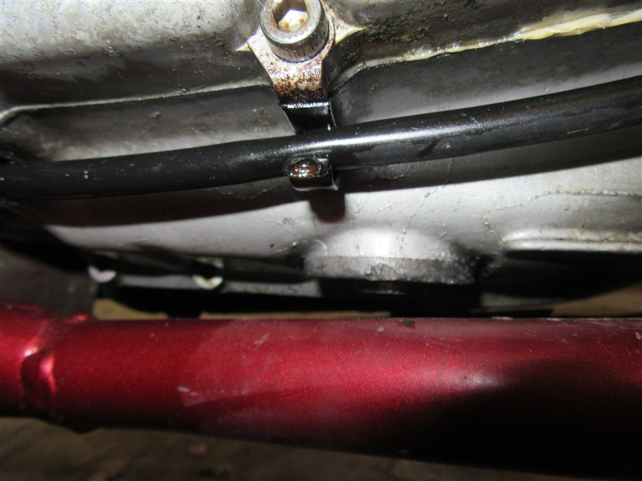

This is the offending sump plug from below:

Oh Ian! That looks a bl**dy awful (polite terminology) bit of "production engineering"!  :(
My only suggestion would be new left-handed drills to remove the remains of the studs, after soaking them with Bulldog BDX, having given them a good heating with a MAPX torch.
As for the sump drain plug, a pox on Yamaha!

Judicious use of a cold chisel to make a notch in the outer periphery, followed by a long punch has got the plug out at least. The "oil" that came out was about twice the normal capacity and stunk of petrol, as did the oil filter.

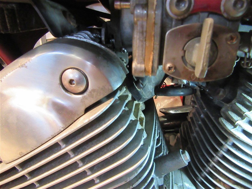

This is the main tap with vacuum blocked off:

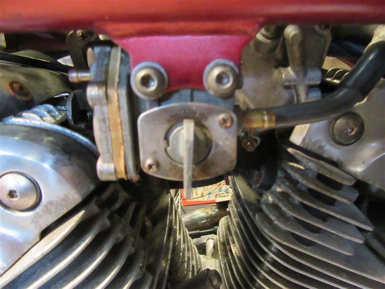

This is the simple on/off tap - note the blanked off vacuum lines to the inlet ports:

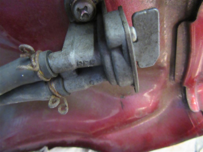

And this the master tap under the back of the tank.

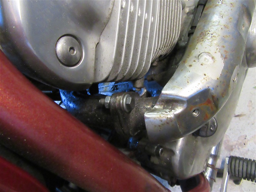

OK. Reattached the exhaust using nuts & bolts - a pig to get the nut on behind (see pic of top one) - I realised for the bottom one it was easier to put the bolt through from the back & put the nut on the front. Fortunately for once Suzuki provided broad enough flanges.
