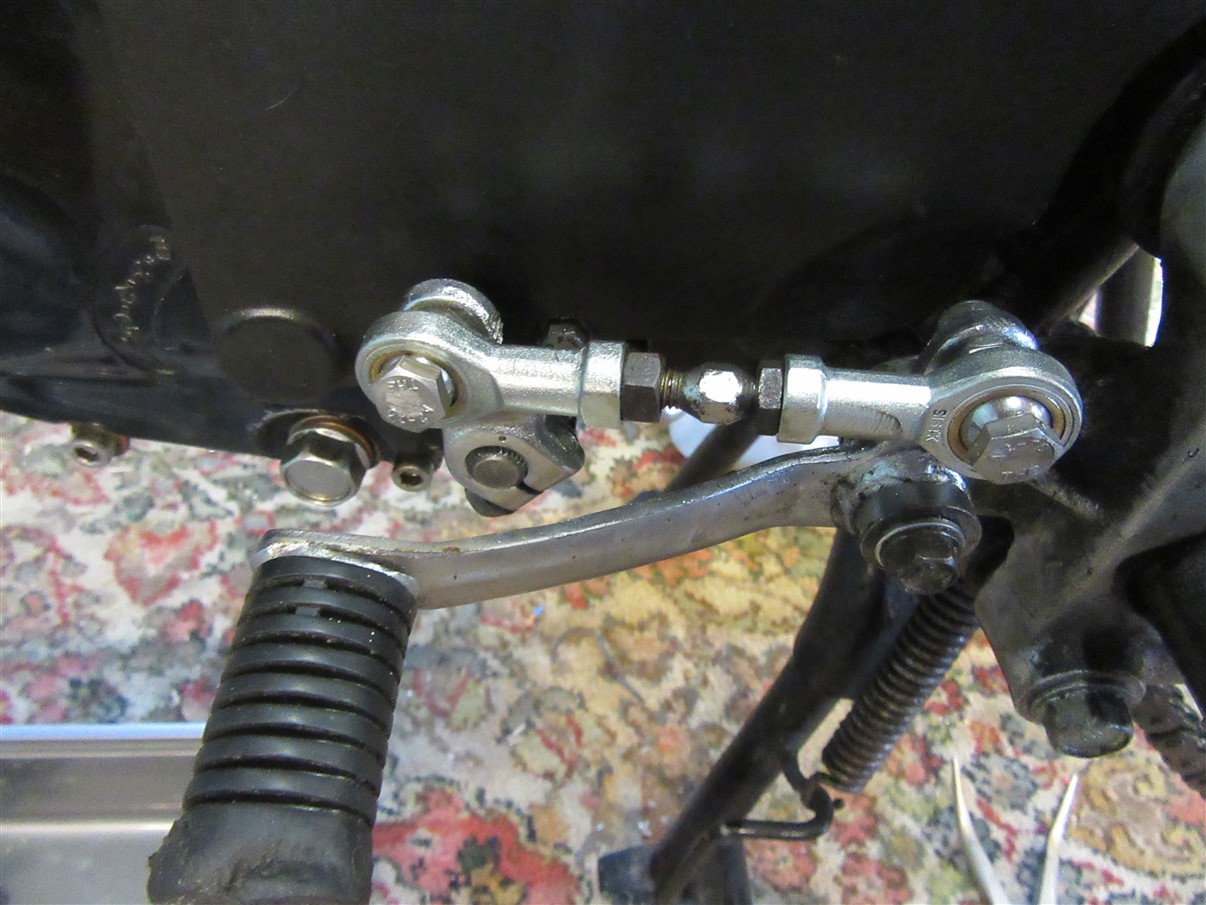

Popped the back wheel off as there was a lot of travel on the brake. The Haynes book of lies suggests a minimum lining thickness of 4mm; the official Honda one 2mm. There's 3mm and a lot of clearance so I've ordered a pair of shoes from ebay - at £9.99 posted not a big deal. In passing, both tyres are unworn TT100s which I haven't used since I had them on The Commando in the 90s and 00s - so nice tyres. Both are relatively recent as well. Without dismantling, the cush drive looks decent so will leave well alone.
The gear linkage was very sloppy so I've removed the ball joints - easy by grinding off the riveted over section on the back of the lever & operating arm - and ordered new rose joints again from ebay at around £5.

Also got some rose joints from ebay and fitted to the gear linkage which was very sloppy:

Painted and fitted the prop stand from ebay, played about with different handlebars - the bike came with Vincent straights so have used some risers I had lying about to lift them a bit. Oiled the clutch cable but it's still a bit sticky. Waiting for replacement brake shoes and gasket set - although I suspect there's nowt in there I need as the rocker cover doesn't have one and I think O rings aren't included.
