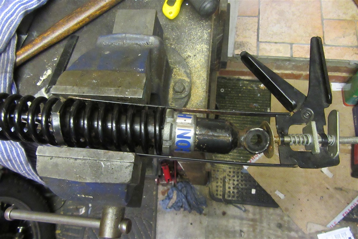

I made mine out of an old mastic gun. Looks horrible but works really well. Strip spring off in a couple of minutes.
I will post pics and video over weekend.

Finally got round to uploading the video of my spring compressor. Here it is
Re: REAR SHOCK SPRING COMPRESSOR
« Reply #17 on: November 02, 2016, 10:48:49 PM »
What a brilliant, and simple idea Ian  ;)

Great idea. I couldn't imagine how it worked, but in reality it's very simple, like all the best ideas!

Thanks for sharing in video format, so that the lunkheads amongst us (ahem!) can copy.  ;D

What a bostin dead simple but very effective idea.........clever man !.

My welding is pretty poor so I thought I might just manage this by cutting through the flanged retainer and using this on the spring about half way down. I held it clamped in the vice to avoid the whole thing exploding across my bench.
When I fitted the spring retainer I was very careful to use pliers and not get my fingers (or anything else) too close.
It all worked a treat although as the springs were a little on the long side it was hard work compressing them.
