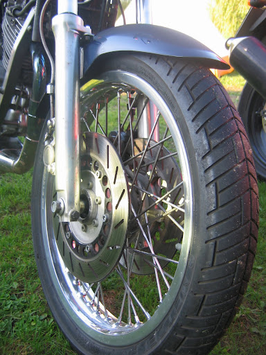

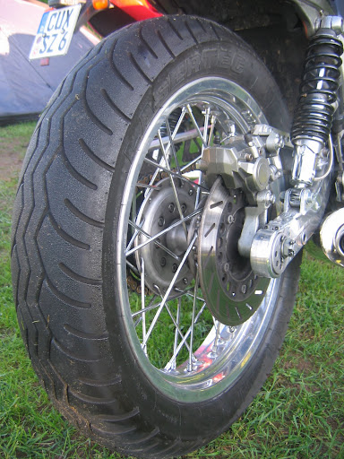

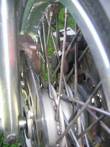

It can be done using the original brakes.
But the brake calipers get quite close to the spokes.
The pictures are from a german bike seen at the monoconnection rally. The front looks to me like an XS650 hub with adaptors made up for the brake discs.
I dont know what the rear is but I beleive XT600 hubs have been used.
I took a different approach with a single 320mm disc on the front
« Last Edit: April 19, 2011, 07:32:49 AM by Steve H »

Thanks for this, great pictures too!!!
It's given me a good starting point for a bit of homework and investigation......  ;)

Unusual swinging arm too!
