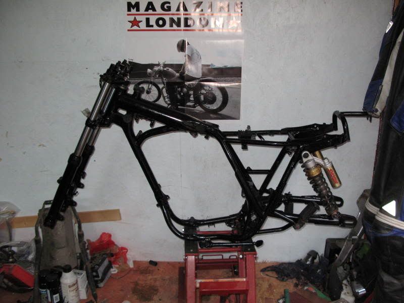

Bought as a rough but running SR500-
Ran it about for a few months to find all the niggles and then stripped it down.

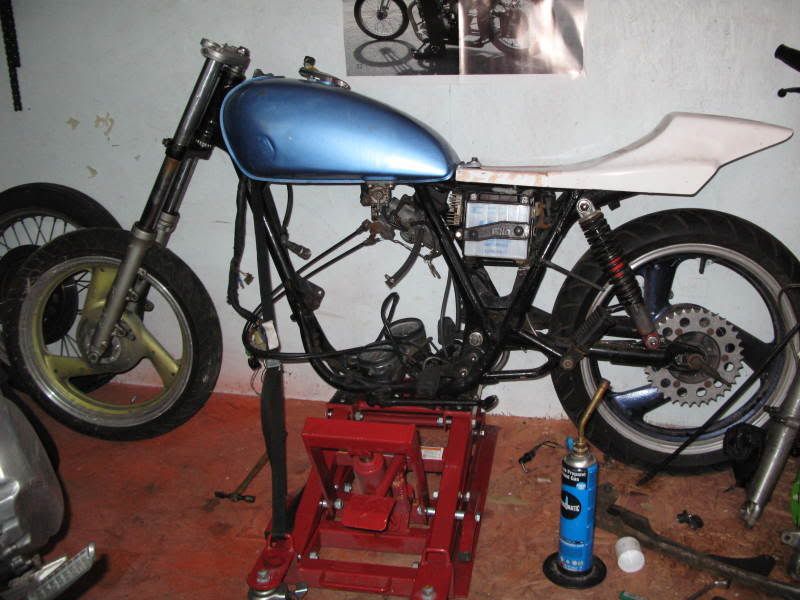

Test fitted a set of FZR roks and wheels I had lying around from a previous scavenge and whilst the front end was no problem, I needed to machine the FZR400 s/arm to fit in the frame and I didn't have time to do it so the 3-spoke wheels were shelved (til the DR came along)

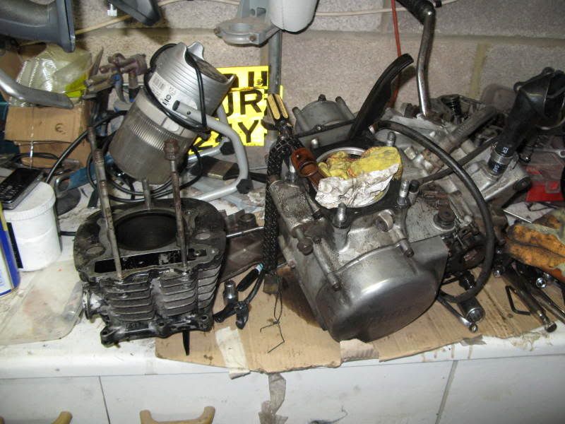

I stripped the engine-
and sourced a few go-faster goodies from the US; megacycle 251-62 (I think) cam, vernier cam sprocket, R/D Ti top valve springs, Wiseco 1st over 10:1 piston, Flow racing 1 3/4" header and megaphone, Supertrapp end discs, and a Mikuni TM38 flat slide from over here.

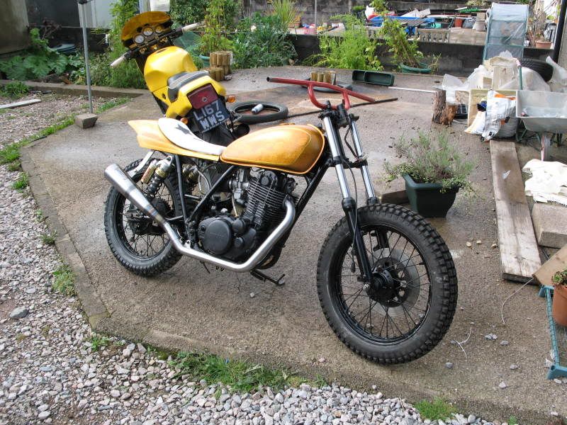

I made some handlebars from some offcuts and sprayed the bodywork, my first time at candy lacework-
Wheels were stripped and painted then everything out back together to trial fit-
Wasn't sure on the bars with the top brace so cut it out so give a cross between Zed and upturned Ace bars.
Got it all done in time for the Ponthir show and even got the g/f to sit on it-
Tank detail-
Was quite pleased with it considering it was all done in the shed. Sold to a London fashionista and it's turned up in a few mags since.
