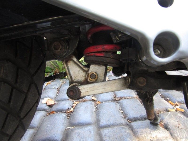

Chopped prop stand received with thanks and on with the job - the shortened bottom link is now in place (after something of a struggle getting the original one off) and all the back end back together. Front end to do next then I'll attend to the carb.

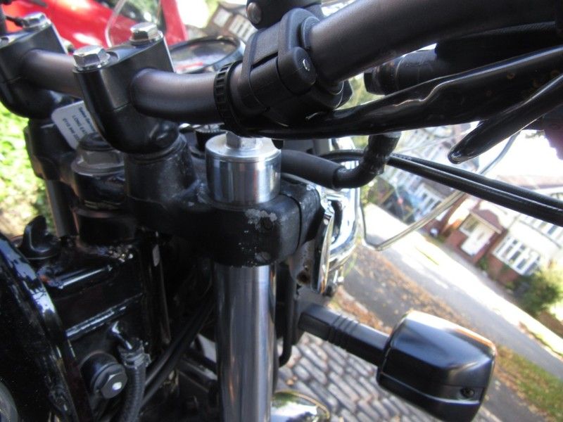

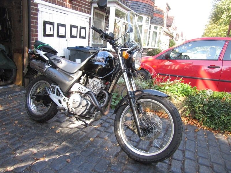

I can now get onto the bike without dislocating my hip - many thanks Tony & Graham. It doesn't actually look that different but handles fine and run very well after fixing the slide lifter in the carb and installing a new idle screw. This may need a final bit of tweaking but it would be hard to improve on the running at 2.5 turns out.

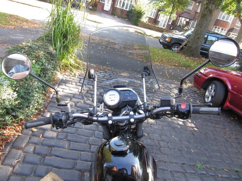

The Givi screen means that 70mph is now very comfortable (although next time I should make sure ALL the screws are tight!); the mirror extenders I knocked up in an idle hour or so mean that I can now see what's behind me instead of my elbows and altogether I'm very happy.
Installed link:
Bike stance now lowered:
Mirror extenders and screen:
Forks raised through yokes:
