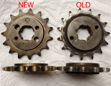

So it was time for me to change the chain and sprockets so I ordered the required parts (all standard spec) through We-moto and begun working.
The front sprocket I got was way different from the old one:
OLD SPROCKETNEW SPROCKET
Spacing between the stopper plate bolts (measured from on top of outer threads)47,2 mm41,5 mm
Thickness from the front to the edge of teeth6 mm4 mm
Thickness from the rear to the edge of the teeth3,5 mm0 mm
I have no idea wether the old sprocket+ stopper plate are original parts, it looks like the old sprocket has been thinned a little with an angle grinder to fit the axle.
I have three problems:
  • The new sprocket is way thinner than the old one and hence won't fill all the space available on the axle.
  • I have no idea of how straight/off my chainline will be with the new sprocket
  • The new sprockets boltholes don't line up with the old stopper plate
I could just drill and tap new threads to the new sprocket, place it on the axle and tighten it in place with the stopper plate. There will be empty space on the axle on the back of the sprocket, but I don't know if that'll be an issue.
Or is this just a case of getting wrong parts from WeMoto?

I got this sorted (sort of..)
The one I ordered is for an FG-model (-85 ... -86), which my bike is according to the frame id-plate. However, the one that fits my axle is that of an SJ-model (-87 ... -88). So now I need to order a new sprocket to fit the axle.
