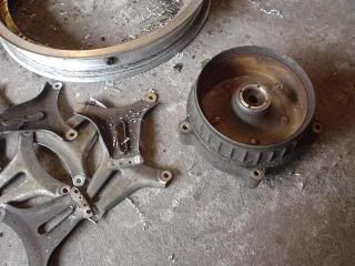

I actually like the style of comstar wheel fitted to the XBR,very distinctive if nothing else.There is a way to convert comstars into spoke wheels:
First ignore all Honda tell you and drill out the rivets and dismantle the comstar.

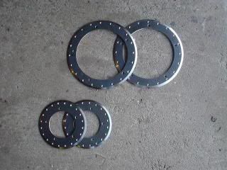

Then make or get made some rings to bolt onto the hub with holes drilled for the spokes.

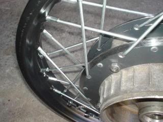

The final product.
Not tried it myself ,found the idea on another Honda forum.
Re: Xbr wheels
« Reply #6 on: February 16, 2009, 10:38:36 PM »
Very neat. Someone else had mentioned this way of fitting spokes and until I saw these photos I'd assumed that it was a clunky-looking solution. But, as usual, I was wrong, that looks very neat indeed.
Any idea on the thickness of the aluminium rings? I'm guessing over 5mm.
